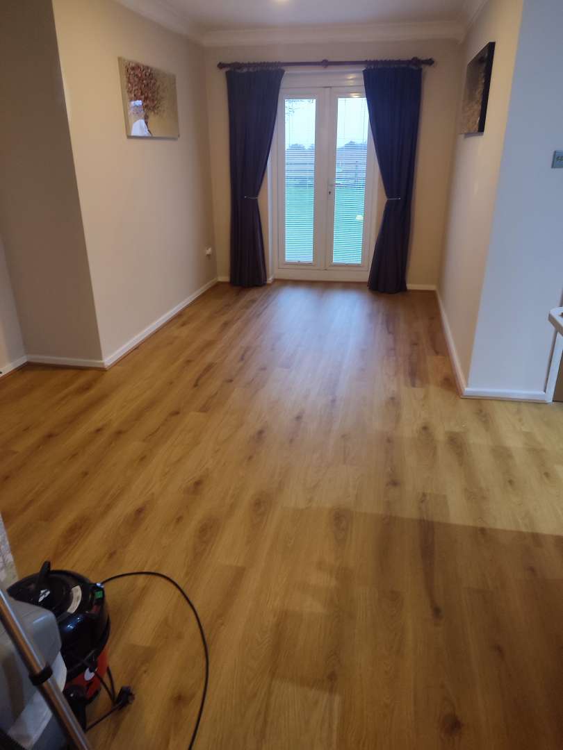

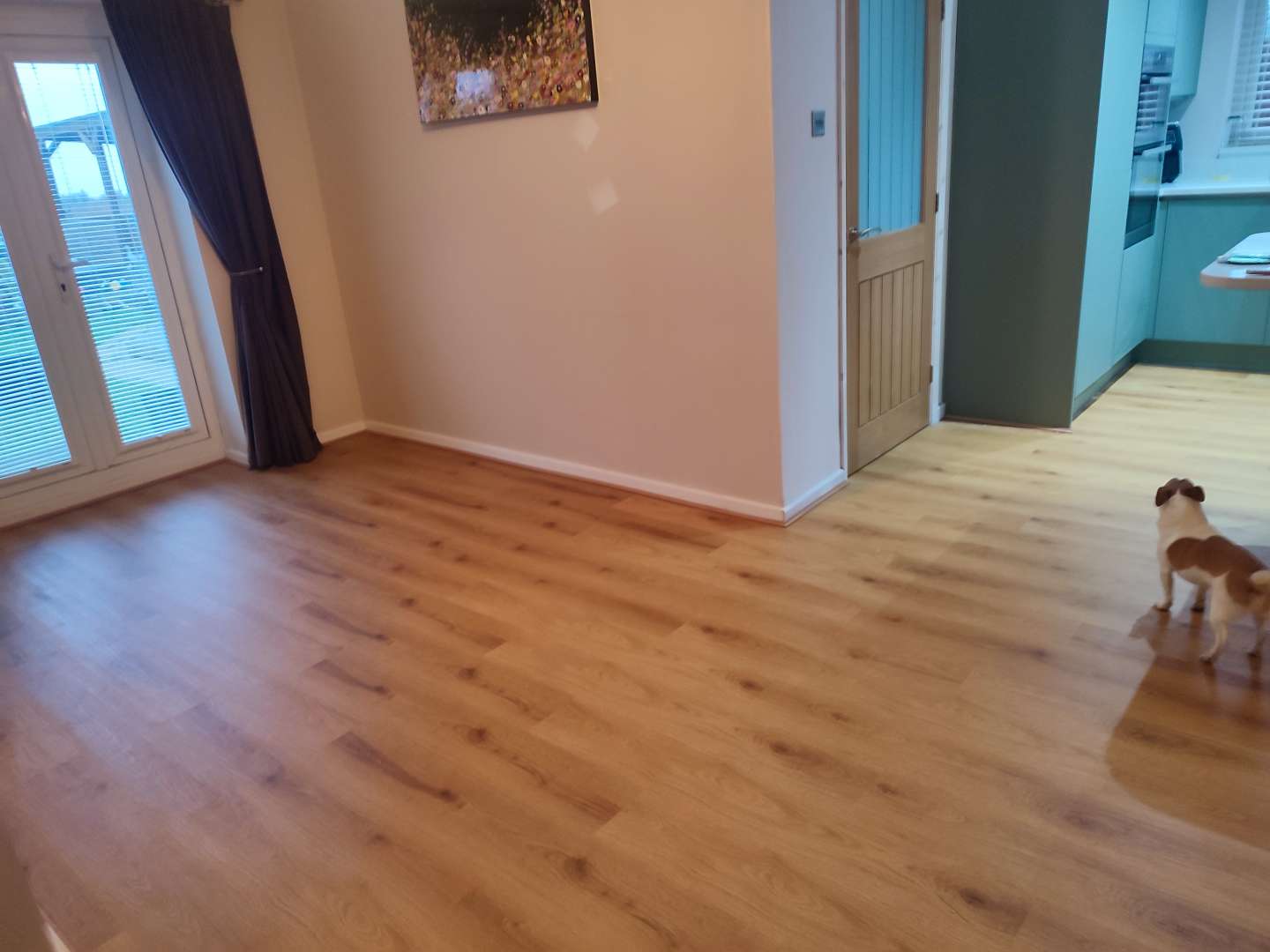

well the floors down now, grandaughters boyfriend (a joiner) did it and he's done a good job.  however, sods law dictates theres a couple of dips that are noticeable when you walk on them, and sods law again theyre in the main area that you walk on all the time.
i watched him put it down and as the cuts are all done now then i think it would be easy enough to just unclick this area (near the finish) and put a bit more self-leveller down before re-setting.  sooooo, we're not there yet, so near 😀

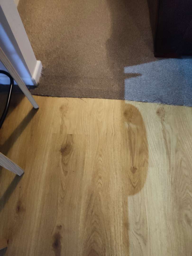

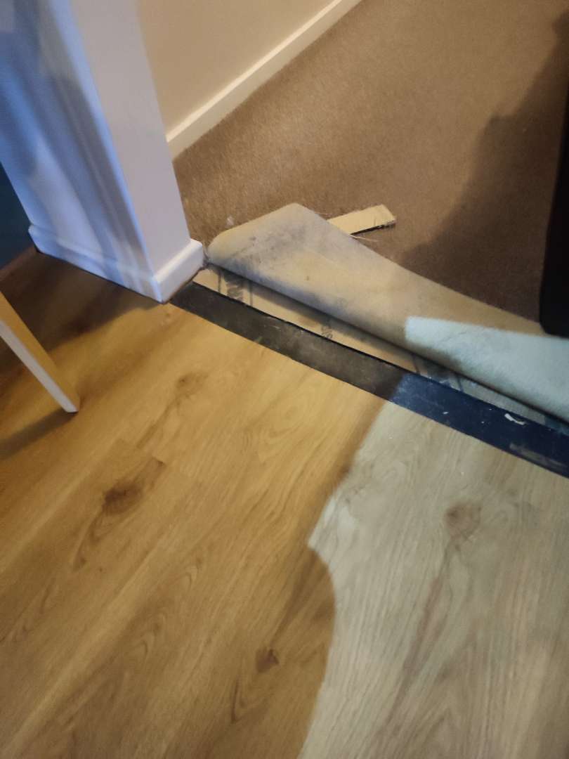

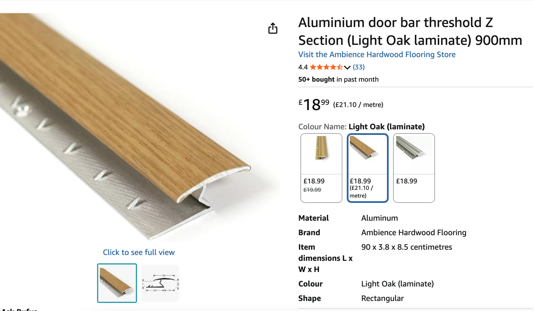

ho hum, not having much success.  ive been out to the local carpet/flooring shops this morning and still getting conflicting advice!
this is my floor as its been left for now, ive left an overhang on the carpet until i know where to cut it.
we'll be having new carpet, but i have to make this good for now.
1st flooring place today said to use 'Z edge' something like this......
the next place said just glue the carpet down, no gripper required, then any wooden T bar threshold will do.  im not sure how secure that is tho.
i also wondered about using that wooden gripper that goes round your skirtings, screwing some to the floor to hold the carpet, but i guess itd be too thick and would make the carpet stand higher than the LVT.
i cant believe its this much of a minefield, surely LVT to carpet joins are quite common, i just cant find a definitive answer.
oh and i need 2m width too, so thats another hurdle as most appear to be either 900 or 1.8m :-/
help please? 😀

Posts: 17762
I think your on your own here 😁
Every time we have had carpet fitted, the fitters seem to treat the edging strip as an afterthought.
When we had our LVT flooring done earlier this year, because it transitions to a bare varnished floorboard, they just used a self-adhesive aluminium strip. I am dreading it being removed when the hallway gets redecorated & we put more LVT down.
In your shoes, I would probably go with the strip you have linked too. Regarding the length - I guess you'll have to use two sections of it?
Posted : 27/11/2025 1:13 pm

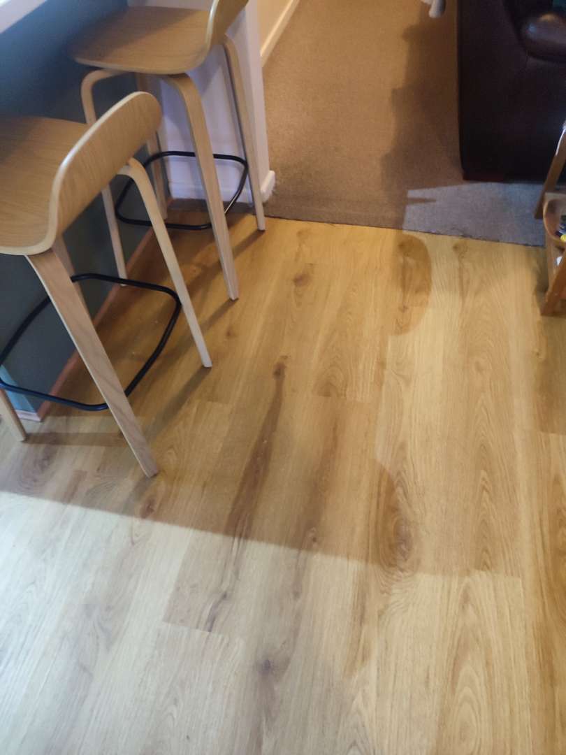

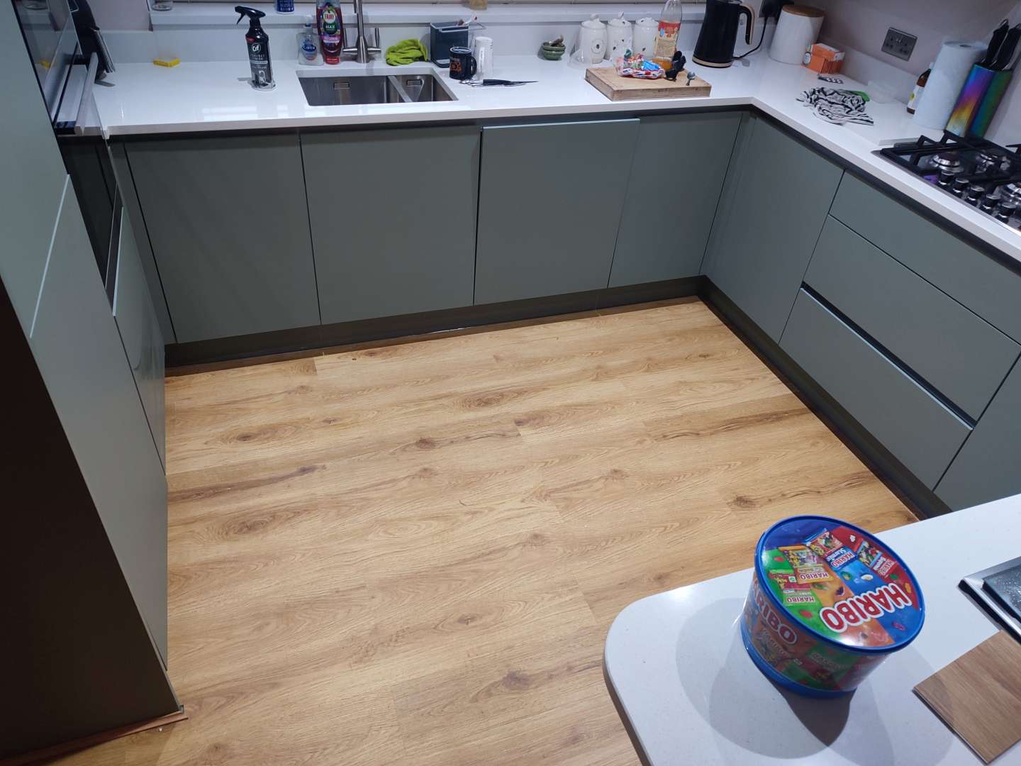

Did you offer Haribo (pic 1 17/11) to sweeten the deal?
i wondered if anyone would mention those when i realised they were in shot 🙂

Posts: 7504
You will need to join two sections. I'd put the join at the centre or the least used side of the doorway. As for joining  to the existing carpet don't use the threshold shown above. They wear through far too quickly. I'd use a solid threshold:
Solid wood
Or a metal one
thanks.  although the doorway is a separate concern, thats 6mm LVT to zero rise, (itll just be a bit of vinyl), so the above wooden ramped threshold would suit that, so thanks 🙂
no, my problem really is a 2m wide gap where new kitchen/diner meets lounge carpet.  6mm LVT to roughly same height carpet.  i need something that will keep the carpet stuck fast (gripper?) and opinions are divided on glue, gripper, z section threshold ^^^ or just bog standard t section laminate threshold, but that would need the cqrpet fixing independantly first.
its a minefield!!

Posts: 4443
I use these guys for weird threshold requirements, have a gander to see if there’s anything suitable https://www.nationalstairnosings.co.uk/threshold-transition-strips/
Posted : 28/11/2025 10:21 pm
Posts: 7504
thanks but no, there doesnt seem to be anything on there that would do the job sadly :-/
