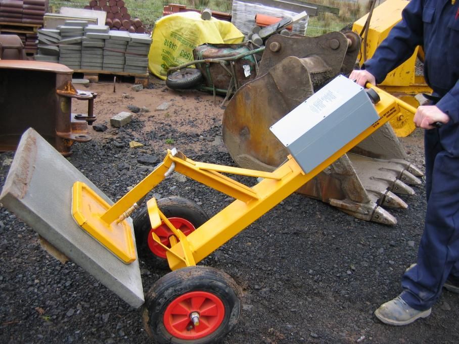

You will need to dig down then pack and flatten the ground and add your slope. this is done with either hardcore or better Dolomite. The slope can go either way as long as you have drainage at the lower end this can often be the house side utilising a down pipe drain. Better still would be to incorporate some form of soak away in the design ( along with proper drainage) perhaps a combination of slabs and gravel.
Hiring a machine like this will save your back hen laying slabs, ( thi is a fancy one )
Edit : It's bloody hard work takes ages and can get expensive if you do it properly. Doing it DIY will save you around 50% in money and cost you a good few days hard work.
