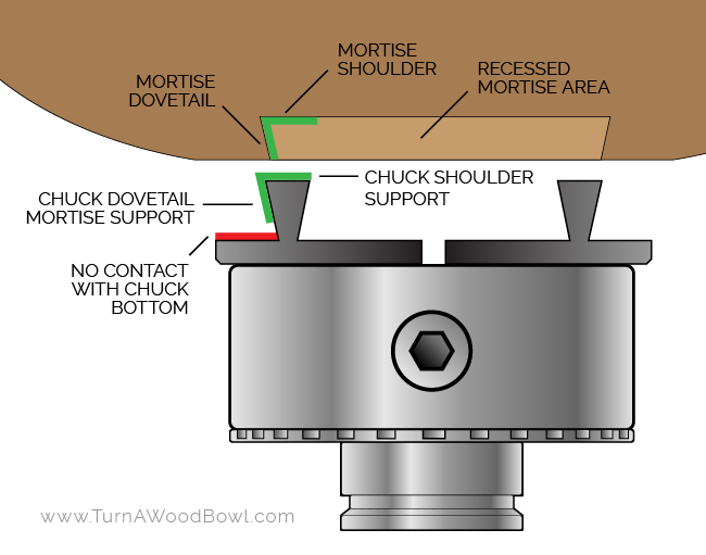

When you turn bowls/vessels like that with the intention of holding them in a chuck, what you can do is to first turn an internal, dovetail -shaped spigot on the bottom of the piece.
Turning-Wood-Bowls-Step-18-Signing-BowlBowl_Mortise_Labeled_with_Four_Jaw_Chuck_Graphic
Then, instead of the chuck clamping onto the outside of a tenon, you use it expanding into the spigot.
That is, if your chuck is able to do this. Most will be and will have tapered jaws to clamp internally or externally.
The process I used to do for stuff like that was to first mount the timber onto the chuck at the open end/top first. You can do this by screwing it onto a faceplate or drilling a hole and using a screwchuck (a big diameter coarse screw that threads into the wood, then you hold the metal screw in the chuck) Any of these methods will later be removed when you turn the inside of the bowl.
So you mount it with the bottom out and then turn your spigot, sizing it to fall within the range of your chuck jaws.
You can then turn the piece around and mount it on the chuck with the jaws expanding into the spigot.
You can then turn the outside, and use the tailstock to add support if needed.
Finally, you can turn the inside.

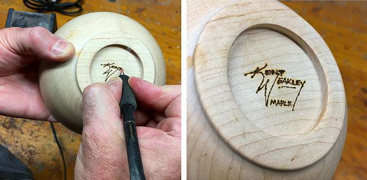

When it's finished, the spigot in the base helps to give it a concave shape and make it more stable.
It's also as nice place to sign your work.

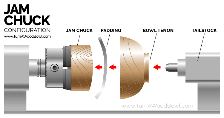

If you want to turn down the base of an existing vessel such as that, another technique you can try is this.
Mount a blank onto a faceplate. Turn a mound/semi sphere shape of suitable size for the vessel. It's called a jam chuck.
Jam-Chuck-Sandwich-Diagram
You can then turn the vessel around, mounting its open end onto the sphere and then bring up the tailstock to support the piece.
This then gives you way more room to turn down into the base working near to the tailstock.
Posted : 15/01/2025 11:59 pm
