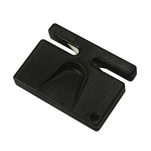

I'm completely useless as sharpening knives with a proper whetstone even though I spent much time practicing as a kid, my incompetence probably saved me some fingers! I got a Gerber Pocket Sharpener a while ago with a multiplier tool and now have a house full of ridiculously sharp knives, it's virtually impossible to use it incorrectly and gives a nice smooth sharp edge which I've not found with any other knife sharpeners. Not as cool as doing it the proper way but the end result is good.
http://www.amazon.co.uk/Gerber-04307-Pocket-Sharpener/dp/B0001WOTEU
