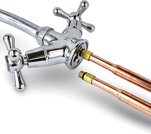

backnut spanner as linked by Johndoh
And then taps I have bought recently have the copper tails as a separate piece, which then screw up into the tap body (I think because enables different sized copper tails to be provided, or even flexi tails)
Posted : 09/06/2024 4:04 pm
also the example above has no clamping bolt thing because that comes as a separate piece in the box, that you first screw into the tap body (the third hole in the pic). It's usually a stud with a screw head (slot) on one end; as Andy4d said you might be able to unscrew that.
Or, turn the water off, unscrew the copper tails, and then you'll have easy access to the clamping bolt

^ shouldn't need to cut them off, they should just unscrew.
Posted : 09/06/2024 4:12 pm
Posts: 1715
As theotherjonv says you should be able to unscrew* the copper pipes first and then you can get a spanner on the nut.
*Unscrewing may involve brutalising the copper pipes with mole grips and making them unsuitable for ever being used again. I think this is what happened when I replaced a tap in the old house. If you're not certain you have all the parts to reconnect the new tap start when Screwfix or wherever is likely to be open for a few hours. Doing it on a Sunday evening may result in a day with no tap. Or so I'm told...

all seems a bit OTT.... the copper tails are just hand tight against the sealing washer, so if necessary a molegrips or stilson and ovalise them a bit to stop slippage should be plenty.

As above, the tap tails should just unscrew with molegrips, they are only meant to be put in hand tight. Then you'll have (a bit) of space around the nut.
