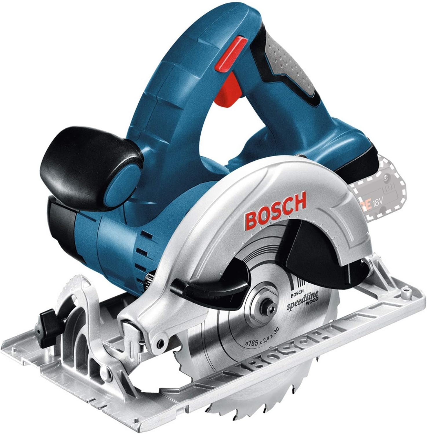

I make and fit wardrobes. I have some fancy things to help me scribe but in a case like this I just dangle a tape measure from the top, measure the gap every 300mm so it would probably go 80, 78, 74, 76, 73, 73,71 etc. I then knock off 3 mm from each measurement, transfer those to my side infill piece and then just cut from dot to dot with an appropriate saw.
Posted : 31/03/2021 7:00 pm
Plus
Posted : 31/03/2021 7:07 pm
Posts: 1715
What Big John said but unlike Matt my weapon of choice would probably be a fairly new and sharp second fix or laminate cutting panel saw like this one (other brands are more of less the same). My mistakes usually happen slower without power involved. Others will have different preferences.
https://www.toolstation.com/predator-laminate-saw/p44726
For fixing a 1cm gap you could bodge cover it with beading or trim if you can't face recutting it.
