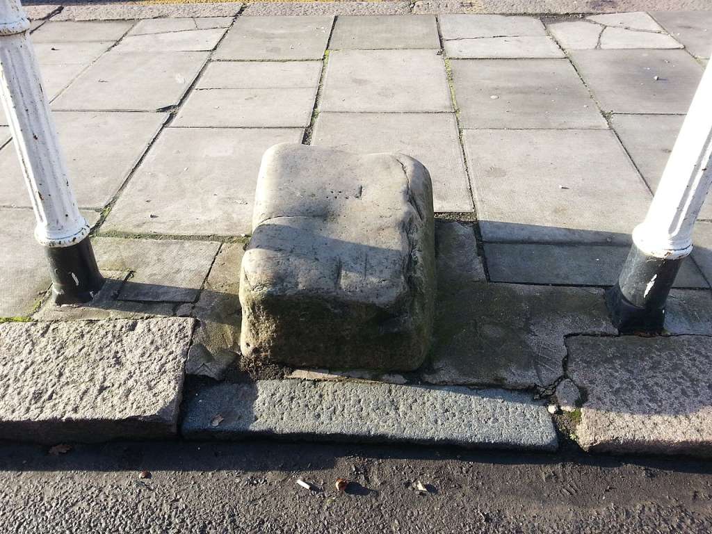

Posts: 4352
The_Whetstone
The Whetstone in Whetstone.
Posted : 22/12/2023 11:41 am
Posts: 4225
The is for the advice everyone. Have dispatched my sister to Enfield with a crowbar as that’ll look lovely in my garden. Hope the postage isn’t too much for her.

Posts: 4352
Enfield? What an insult. Whetstone is in the London Borough of Barnet, and shares a tube station with Totteridge.
