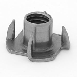

Bit of marine ply - drill a grid of holes and use m10 t-nuts on the other side. Perhaps make it overhang very very slightly.
This means you can move the holds around really easily to make it harder/easier and basically keep her interested. Also means you don't have to stud your brick wall with loads more holes.

2 x 3/4" marine 8x4 ply boards mounted to wall giving 8ft sq board. Mount that 1ft up so max height is 9ft and put a 1ft kickboard at the bottom for starts. 8ft sq section will be mounted on frame giving 10-15dg angle (Not sure yet how much).
I bought 50 holds and mounting hardware the other day for £93 delivered and plan to buy some more of them t nuts so I can basically move the holds anywhere I like.
I am having the boards and frame supplied FOC so I just need to buy the holds and fixings and then fit it which helps.

1) The correct size drill bit for drilling holes for the M10 t-nuts

Next job is to drill the holes. Anyone know what size bit I need for M10 t nuts??
Posted : 20/04/2015 8:41 am
 igm
Posts: 11833
I used a 10mm drill. The t-nuts wouldn't push in but went in fine when tightened in with a bolt. And that way they won't come out when you don't have a hold attached to them.
12mm at a push but ideally 13mm spade bit.
10mm won't allow the body of the T-nut to pull into the hole you've drilled - think about it - there's 1mm of steel all the way around the bolt. 10+1+1 = 12mm
Have built dozens of walls over the years and we always use a 13mm bit.
2lb lump to put them in from the rear and the tech-tip is from the front BEFORE use - have a buzz gun with a 13mm socket and a 10mm hex bolt with a repair washer to wind it up nice and tight.
Make sure though you are really really careful when you buy your holds/t-nuts as many manufacturers actually supply old school imperial thread bolts - especially where they need a long/shanked body/cap head.
Make sure you check otherwise you end up with a wall with lots of "M" and "I" marks next to the holes.....

Thanks hammy. Had done a bit of googling and came to the same conclusion. Seem to recommend a 13mm brad point bit.

I pulled 12mm outer diameter nuts into 10mm holes in hardwood ply no problem at all.
A drill tends to cut slightly bigger than its nominal size and wood is slightly plastic (as opposed to elastic)
I did look at my 13mm bit but it would have been a little large.
To be fair I doubt I could have hammered them in cleanly.
Posted : 20/04/2015 12:03 pm
I used a 12mm bit, whacked them in from the back, then used a block of wood with an M10 bolt through it to pre-tighten them from the front (you MUST do this or your t-nuts might just pop out and spin helplessly behind your wall the first time you try to put a hold on).

Some say 12mm, some say 13mm. I say try a 1/2"

Spent last night hammering the TNuts into the holes I have drilled. 140 of them 🙁 My wrist was knackered by the end of it.
I then rigged up on of the bolts to some washers and a block of wood and tightened all the tnuts up to ensure they were square and tight.

2 boards are now fully tnutted and I have nipped all 140 of them up using holds and bolts to ensure they are pulled straight and tight. Painted them both with outdoor undercoat (White) and once I get a couple of strong blokes to help me lift them into place I will screw them to the frame with decking screws. I can just about lift a board to move them around, no way will I be able to lift one 5-6ft off the ground.

Big slopers are ace, and it's actually quite easy to make triangular volumes from offcuts (although they can push the climber out from the wall quite a bit which might not be ideal with your fence).
For clipping practise you can just screw a bolt hanger into any of the T-nuts and put a quickdraw on it - hangers only need to be fixed into the supporting structure if they're going to take lead falls.
Recent bouldering comps I've done have pretty much been 90% problems with big holds/volumes/3D weirdness and 10% pulling on small holds, but Martins suggestion about going to a proper bouldering wall for that sort of thing is a good one, you'll have trouble setting that kind of problem so it's probably best to keep your wall simple.
At that angle a set of screw-on holds is great for feet, but look for some which aren't positive. Some of the sets of screw-ons have very good edges that make them easy for the feet. Something like this is harder to use: http://www.jegrimpe.com/product_info.php?cPath=22_32&products_id=2552&osCsid=3030faeb76e97473a32470dcbdd558d2
