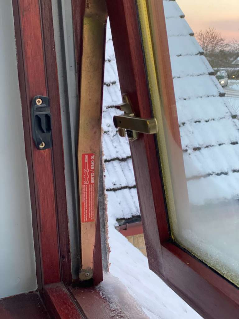

Our double glazing is about 20 years old I think. As you can see from the photos, on a cold day I'm getting a bit of condensation in the bedroom, and it certainly feels cooler near the windows than elsewhere in the house.
They are lovely units that still seem to be in good condition, but I guess window tech has moved on?
Is there a trustworthy resource for researching windows to help me narrow down the choice and figure out how much to pay? Can someone just tell me what to get? I know that once I start getting quotes I'm going to be absolutely baffled by the options and price range.
I really don't want to shell out £1000s and have windows that look worse and perform only slightly better than the ones I already have, so reassure me that this is worth doing please and help me through the minefield!
IMG_6085IMG_6086

I was talking to the guy who makes my [wooden] windows and he was saying that the tech in the glass has moved on in the last 5-10 years - by how much I don't know.
You could just replace the glazing units if you thought it would help but if they're pretty thin ones then you might need new frames also.

Do they actually seal still?  Next time it's windy, light a match and blow it out (or use an incense stick if that's your thing) and hold it near the seal to see if anything's blowing in.  All the windows upstairs in our house developed gaps after 15 or so years.  I think the hinges weren't lubricated, which made them stiff, and opening them put strain on the pivots. They they became slack so there was too much play, and they didn't seal.
New hinges can be fitted yourself as long as you have two people - but tie a rope around the window and your waist in case you drop it!  It's quite a fiddle.  You can also replace the rubber seal around the edge but there might be one on the frame and the window as well.
My daughter's room was always freezing, but I changed the hinges and now it's way better.  The gap was not even credit-card thickness.

if the frames are sound and the double glazed panels arent blown, i'd look at getting them refurbed with new seals etc.

as above, seals and/or hinges are replaceable and often this solves draft and noise issues.
A company that sells windows might not be keen to offer this…
Try a window repair business or even ask some local handy people. Seals are easy DIY, hinges are moderate DIY.
The seals can be bought on eBay, there’s a bewildering array so pull a bit out and match up.

As mentioned above, 2 main aspects: the seal between the opening casement and the frame (see thin possibly rubber seal in OPs photos) effect of hinges also mentioned and the seal between the actual window frame and the house wall, often hidden by architraves/trim. Basically the seals/mastic/mortar etc dry out and shrink back and thus leave a small gap and hence you can get a draught. So not always the double glazing seal or the window, sometimes the detailing. In essence buying new windows Could help in all these areas, but some maintenance attention may also help for less money more DIY;)
Edit: also worth checking seal on the outside, possibly cement band in OPs pic, look for cracks/gaps.
