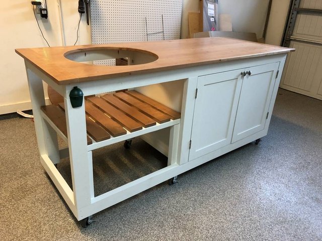

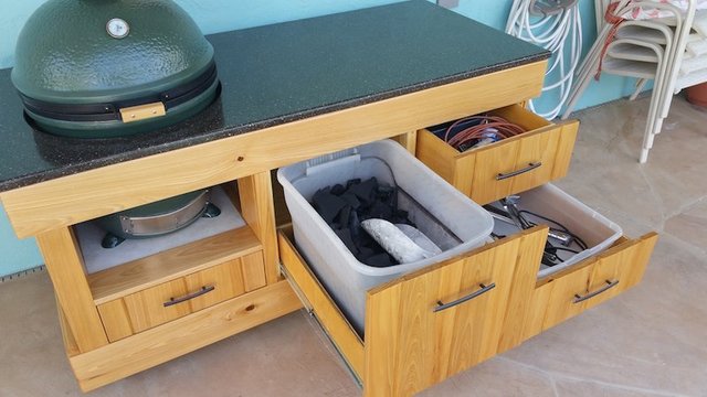

I’m looking to make one a table to house my monolith Kamado and store my ooni pizza thing, along with the charcoal and other outside cooking stuff I’ve got.
It’ll be on castors and largely be an enclosed design, think cupboards and drawers, but it’ll have to live outside, mostly uncovered. Yes I’ve looked at stainless ex catering stuff, but there’s nothing in the right size with cupboards.
I was planning on making the framework in 4x2, hadn’t really figured out what to use for the outside that would be weatherproof. But on the top I was hoping to inlay tiles as I have some great blue tiles that would look great, but I’m also not too sure how to do the worktop so I can do this and the top is all flush and one level.
One of the cupboards would have some sort of pull out cupboard that would contain part of my mountain of charcoal.
Any advise on what type of wood I can use to make it weatherproof etc and seal any doors, drawers. And how to do the worktop to inlay tiles..
The unit will be approx 1900mm or so long, 600mm deep
Hopefully by the power of kayak23’s post image post, there could be some images of what I’m hoping to make. (FYI it did need the STW IMG magic)
Table 1
Table 2
Posted : 23/01/2022 12:04 pm
Sweet chestnut, Douglas fir, larch, cedar, teak and various other exotic hardwoods.
Your design needs to shed water so no ledges that hold water (or shaker style doors are bad)
