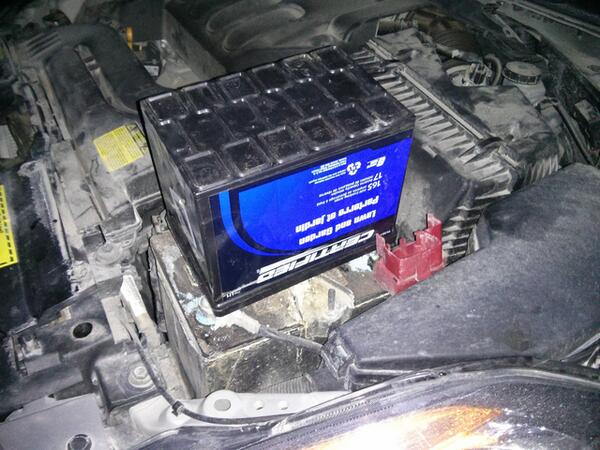

My 2002 focus has a 'special' battery (not lead acid) and a smart charge system driven by the vehicles power control module.
I.e. when the car starts, the charging system can push up to 18V if it senses a cold engine or poor battery condition.
Now, if I jump a car with a 'poor battery', my alternator/pcm will possibly push 18V into the other car and my car and possibly fry all manner of modules.
Unless stranded, I'd probably pull the battery and pop down to the dealer and have them put it on their test station and charge it up for me 😉 5 year battery warranties are useful for some things at least.
