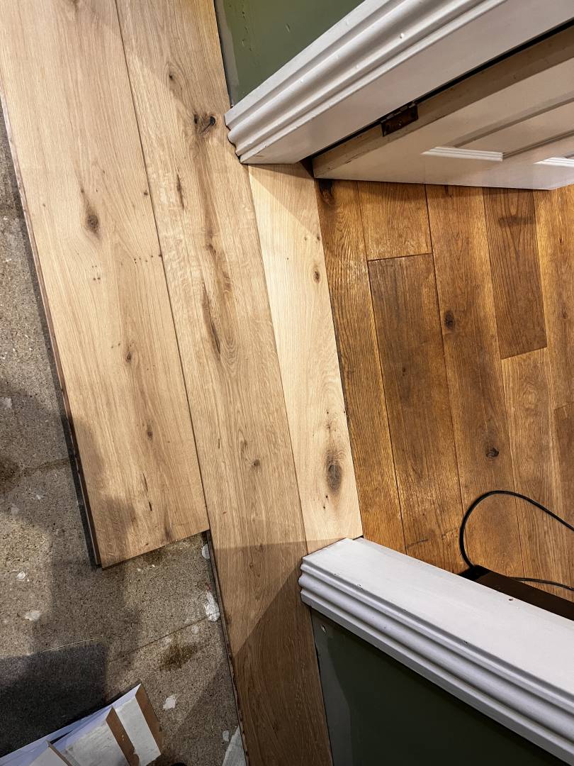

Ive got an engineered oak floor in the kitchen that I put down 4 years ago. T&G glued joints and the whole thing is floated over a chipboard subfloor with the foam underlay. 90's house, no issues with damp or movement etc. oh - and its unfinished oak with Osmo polyX applied after fitting.
im now ready to put down the same in the hallway. instead of using a threshold strip id like to attempt to join onto the existing to get a continuous floor. Im aware this might not work buy my logic is if the joint fails, I can route out a channel and put a threshold in in the future and im no worse off for trying
Ive mocked up and dry fitted the boards shown. ive got a biscuit jointer so my plan is to put 3 or 4 biscuits across the board and glue the joint with either the D4 wood adhesive ill use on the other joints, or a thixotropic gel adhesive, then give that 24 hours to go off before I continue with the rest of the floor - sensible??
under that bit of board i could just use foam to match the adjoining board but I was wondering if it would be worth setting in on a bed of gripfill or similar to make sure the board has zero deflection to stress the biscuits? I also thought I could isolate the board from the glue with a layer of masking tape or baking paper so that it remains free off the subfloor - good idea or am I overthinking it?

It sounds like you've got it all figured out really well to be honest.
To get pressure onto the join, you could screw a temporary batten to the chipboard so that you can tap some wedges against it to push the board sideways onto the joint.
Otherwise, everything you say sounds really good I reckon.

Ah yes temporary baton and some wedges is a great shout thanks kayak

Posts: 188
FYI.
We had a floor that was already fitted when we bought the house (thick, engineered not oak), spanned 3 rooms in one run/go.  In the heat it would expand and raise the floor by 1 or 2cm!  (Some cut a gap and shoved a threshold in the gap and that solved the expansion problem).
Make sure you have enough expansion.
