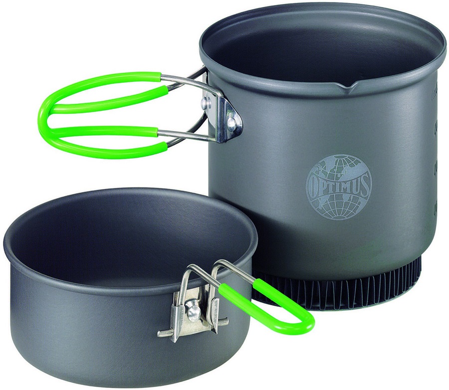

My "larger" bikepacking pot set is the Optimus Terra Weekend. The pot on that has a HE and I've always said that it makes for a more flexible, but similarly efficient, set-up when compared to the Jetboil-alikes.
I've never tried it on the kitchen cooker though.

@scoutroutes that's exactly the pan I've got from decathlon years ago. With a soto windmaster it's brilliant.
