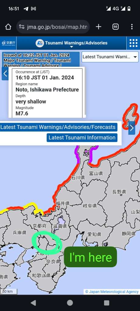

Posts: 2295
Daughter is in Kyoto didn't feel anything but are advised not to travel to coast, purple are is being evacuated.
IMG-20240101-WA0000
Posted : 01/01/2024 10:16 am
