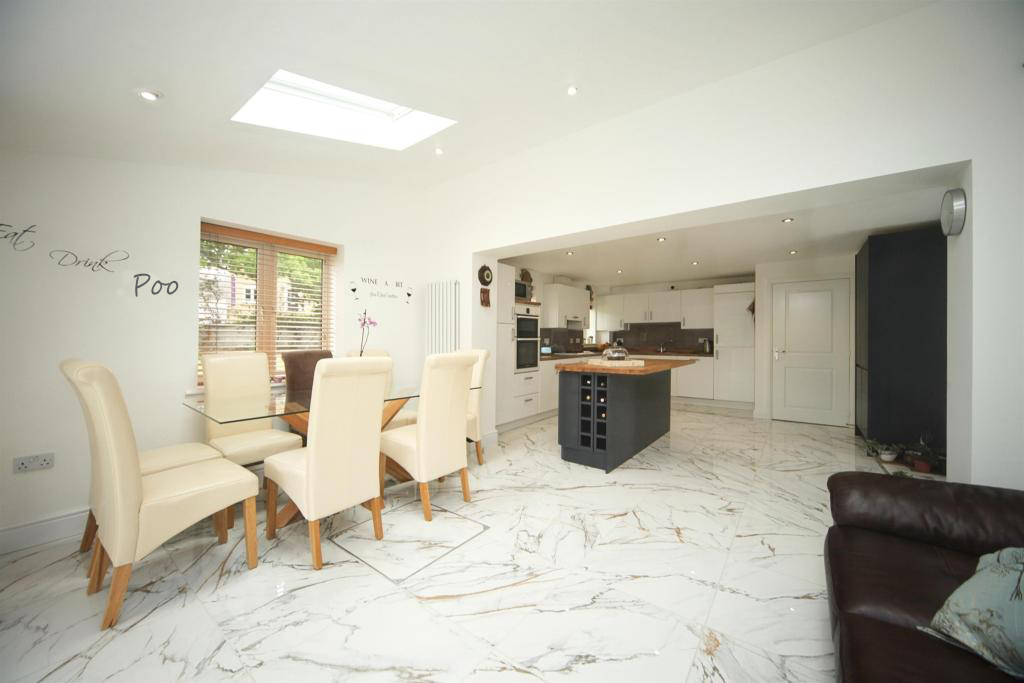

Just browsing houses, and noticed that one i was interested in appears to have a manhole cover in the kitchen extension floor. Not sure when extension was done, but is this an acceptable thing, or a walk away from it bodge?

Yeah it's inspection chamber lid, is the kitchen an extension? Fairly common to see that when it's been extended over existing drainage runs.

i think the kitchen was where it is but they've added the dining bit on as an extension. Is it a special sort of cover if its used internally, and anything i should ask / be aware of?

My neighbors have one in the kitchen after they went over the drain.
Only 2 houses on that drain us and them not my cup of tea

I'm guessing there's no quick and easy way of knowing if it is just draining from this house of if it's a shared drain? Need to decide tomorrow and put an offer in if it all looks ok!

The wall between the kitchen and the dining area looks like an external wall.
It's not really my thing either. It would make me wonder why they didn't move it.
It's certainly not ideal!

My Dad’s house has a similar thing in his garage extension/workshop. It’s backed up a few times and flooded his workshop with actual shit before. Luckily one time I was away and the other time I had a broken leg so didn’t get involved but put me off anything like this!
There are sealed covers which supposedly prevent that so maybe it’s fine but I’d want some kind of survey or at least explanation or similar to confirm that

The inspection cover is ok if its a proper sealed and secured version, the graphics on the wall however, would put me off my food!

Obviously your solicitor will need to check that you have build-over permission if it's a shared drain, and your surveyor needs to give you a view on what would happen if someone got a turdpedo stuck in a fatberg a bit further down the drain.
But there's nothing to stop you putting an offer in unless you're planning to skimp on your loo diligence.

The planning application for the extension should be held by the local authority and may have useful info. Some LAs put them online.

Surely that falls under building control rather than planning?

Sewer network specialist here.
TLDR - I wouldn’t want it.
If the house is otherwise ok then I would check if a build over agreement has been obtained from the local water company. I very much doubt it has been - only exception might be if it was built before 2011 when the water authority wouldn’t have cared and it would only have been down to planning or BR controls.
It’s not a good idea to have a manhole inside. Really bad idea. First you will get odours. Secondly you could get rats (surprisingly not that common). Most importantly the flooding issue is real. I could show you pictures of internal sewer flooding which would make you vomit and if it blocks downstream you will get sewage flooding. It’s an awful thing to happen.
If it’s a shared drain then the water company can come and unblock any problems but bear in mind they have a legal right to access their assets (if it’s shared it’s owned and controlled by them) and just think what would happen if they had to rip the sewer out and replace with new? Sometimes you can use fibreglass liners but not always.
What they should have done is rerouted the sewer around the extension when it was built. This clearly hasn’t happened.

We have something that looks very similar to that in our kitchen. With us it is access to the rainwater cistern.  No odours and no chance of overflowing as there is a drain near the top.  Can be a bit noisy if it's almost empty and it starts raining but I like it now

We built an extension over a shared drain. Had to get a camera survey of it for Scottish Water, who then approved building over it but specified lintels, new access points etc.

We had the same under our extension. We moved the manhole to outside.....
Being in Scotland this wasn't an issue.

Our in laws had a 100k kitchen refurb plus extension built over an access cover. They now have water backing up to the sink plug hole and have to avoid running water for 24hrs to use the washing machine. Obviously there’s a block which can’t be found which is backing things up.
They’ve been told there’s no more options other than to lift the floor and investigate that access cover.

I know of a property where the kitchen (original, not an extension) was over a Victorian era drain but with no access/cover. When there was a blockage or air pocket god knows how but the stench drifted up. I would run a mile.

We are planning an extension - we have an inspection chamber just outside the existing conservatory, which when the build is complete will be inside the extension - we are planning to move it just outside, however it is not always that easy depending on what you are looking to do. Our existing drains run under the garage and the slab, so moving the inspection chamber means moving the whole run about 4 meters further out and moving 2 existing inspection pits.
I forget how exactly I who I spoke, but I'm pretty certain the relevant water board can tell you if the drain is shared or not. I don't remember paying for this. Ours isn't shared with our neighbours.
Our drains are however both rainwater and grey water, which I'm told is no longer okay, and we need to build a soakaway for the rainwater now as well.

On the rats point, I cant see the relevance. If the rats are in the sewer, the only way they can get into your house from the drains is via the toilets, which you all have, they can't get through a sealed cover. I will caveat, as we had rats in the garden, and digging them out, I found the nearby inspection chamber had a crack in it (its about 2m deep, right near the cover). So I filled with steel wool and concreted. No more rats. Till maybe they swim up the waste pipe....

The house looks top be on a new-build estate so plans of drainage routes should be easy to obtain.

I actually quite like the kitchen ! not sure on the graphics but that is easily sorted. It looks like normally the table will actually be over the inspection pit so if you don't like the look of it it is easily hidden.
Not moving the inspection pit may have been budget, or it may have been a limitation of the plot. I wouldn't even want to get into what a pain in the ass it would be if it was a shared sewer with your neighbours and you wanted to move it. Can you ask them to not flush the toilet for a few days whilst you relocate?!

Presumably you would complete the new drain and then divert the connection reasonably quickly once it was ready to accept passengers?

I wouldn’t even want to get into what a pain in the ass it would be if it was a shared sewer with your neighbours and you wanted to move it. Can you ask them to not flush the toilet for a few days whilst you relocate?!
Sounds like the hard way to do things.
Assuming the inspection covers on a straight bit of pipe Moving the inspection cover can be done entirely non invasive.
The issue comes if as they often are -on a change in direction you can't do much about it without moving lots.

We would have this issue if we go more than 4 metres out at the back, it's the same with every house in the row, nobody has taken that jump to go past that point yet, 3 metres is the furthest due to all the issues raised already, especially permission.

Moving a drain isn't necessarily straightforward if you're limited by the fall in the pipe.

If it is drains or sewer, get it moved.
It might not be drains at all, my sister has a similar access hatch in her downstairs loo, this provides access to the "cellar" - more like an under floor void.

Looking around the outside of the house I can't see a stench pipe anywhere. Certainly none on that back wall next to the grass area which is where you'd expect it to be given the location of the bathrooms.
Kind of suggests the drains run internally anyway.

looking at the wider photos. it doesn't really make sense it being an inspection hatch for a sewer. bathrooms are in teh middle of the house, mains sewer would surely be under the road at the front of the house. you can get a map from the water company and its new enough it should be up to date-ish.
I think its a hatch to access the area under that extension as it's likely to have some space where the ground falls away to the side.

We have this in our house. Due to the litations of the site we had to build over a manhole cover.
Key thing was it is serving our property only. We had to specify a double sealed manhole cover which we set into the concrete slab above the old manhole cover.
If however it is a public sewer then you need permission and have to leave access for them. That lid you are looking at looks easily accessible if required.
I'm lucky that I have a other manhole cover downstream in the driveway so every couple of weeks I lift it and run water through the drain that goes through the internal cover to ensure it is all flowing properly.
If it serves that property only then it shouldn't be a problem as you know what's going into it. If it serves someone else then you have the problem that they may flush nappies etc down the toilet blocking the pipe and you only find out about it when you are ankle deep in sewage.

We were never told as students that we were not on mains sewage, so a house of 5 woman put stuff down the toilet that needed flushing.  Only found out when the manhole covered lifted in the garage 3 doors down...
Really really not good!  Avoid if its shared - like others have said.

A friend had one of those in his flat. It had been hidden under laminate flooring. You can guess as to how he discovered it.
We have one in our kitchen, we discovered it when we replaced the flooring just after we bought it and moved in. It's under the extension and in a direct line between the original soil pipe (boxed in inside the extension) and the point where it joins the shared drain across the front of the house.
Next door recently rebuilt their single storey garage to a double storey extension, and the shared drain runs right under that...
Normally a manhole is built where there is a bend or where connections come into the line. There not really any reason to build one on a straight line unless it’s a very long run. They are needed on bends and connections as that’s where you get most issues and where a jet hose or rods is needed to be put down.
If it’s in a house it’s probably a junction allowing the kitchen waste to be hooked up to the rest of the system.
Posted : 10/06/2022 2:44 pm
it doesn’t really make sense it being an inspection hatch for a sewer. bathrooms are in teh middle of the house, mains sewer would surely be under the road at the front of the house
You can get sewers absolutely anywhere. There’s never a rule where they will be, every house is different.
Water company may have a map but they aren’t usually very detailed at the house level as they only took responsibility of the pipes leading up to individual houses in 2011. Before that they only dealt with the main sewer.
Posted : 10/06/2022 2:47 pm
Not moving it is a bodge. It’s rare to have so little fall that moving it a short distance isn’t possible.
Posted : 10/06/2022 2:48 pm

They're fine if done properly, eg sealed, screwed down airtight lid. And, as others say, it has permission if it's a shared sewer build over. Nearly every commercial building of any size has them, due to the fact it isn't possible to get all the chambers outside the footprint of the building.
Every house on our row has one in the straight section to allow everyhouse their own rodding access houses.
Much handier to have a hatch than a rodding eye. But yes costs have been cut in new builds and this is less likely.
I have a second in my garden at the change in direction.
Posted : 10/06/2022 4:07 pm
My next-door neighbour built their kitchen extension over the shared lateral drain and over the grate that takes their own domestic foul water.
Thankfully, when the extension on my own house was built whoever did it saw fit to move the drains properly.
All this was done before I moved in. The neighbours one was done about 10 years ago. My own extension is probably about 30 years old, I estimate.
Talking to my neighbour, they probably never had planning control sign-off on anything. Some amateurish builder basically just built it, and this was reflected in the shoddy roofing work where the adjacent structure joins to mine. This cost me about £1500 to fix a few years ago when improper construction caused water ingress next door. It really pissed me off.
I doubt they have a build-over agreement either because she (the neighbours) doesn't seem aware of this. If I owned next door I'd be worried about sewer surcharge issues (as mentioned) and the possibility of the utilities having to get access, which could, in the worse case scenario, mean they need to start knocking things down.
Lots of little things to look for when buying a house. Sadly, you don't become aware of them until you've owned a house for a while or working in the trade.
