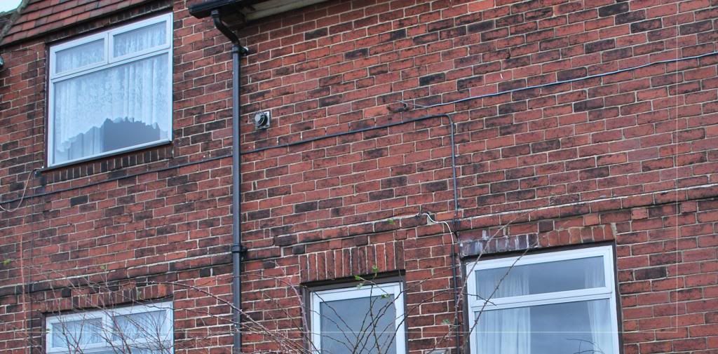

The pics above, are for the top window in this pic.

Well I've been in "the trade" 20+ years now and do know may way round a bit of stuff.
That window looks like its carrying a little gable above which is hung tiles. The actual roof weight above it will be pitched onto the main roof either side of the window. Is there possibly one course of brickwork above the window at most?
Posted : 02/03/2014 8:32 pm

Bear, regarding the lintels, from down here in Derbyshire I can possibly establish a couple of things from the that elevation photo.
Firstly when the windows have been replaced in the past they've disturbed the brickwork above, hence it having been repointed. This would again back up the theory of wooden lintels only on the inner skin.
Secondly if you look at the course 2 above the windows they've sent headers through. I would suggest that these possibly bear back onto the lintel to act as a corbelling detail, therefore picking up the outer skin. This would only work if the walls are solid 9"
In short I think if you replace those windows you will again get some disturbing of the brickwork above.
[u]If[/u] I was having windows fitted I would try and get some support in for the front course. If you don't any weight bearing on modern plastic frames can affect the ability of the windows to open/close properly.

wrightyson has it sussed old wooden frames where often used as load bearing (kind of) but you can't do the same with uPVC

WS, thanks. Admittedly I had to google a couple of words that you used, but looks then that I need lintels in all windows. Not bloody cheap apparently (£1500 on top of the DG quote on average).
