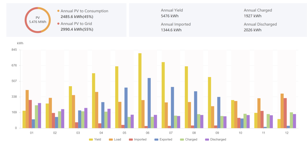

Posts: 10539
Yes a battery can make sense.  We generated around 6000kWh and used around 5600kWh.  Of that we exported around 1600kWh and Imported the rest.  Without the battery, we’d have likely imported around 3500kWh instead of 1200kWh and would’ve done so during the peak periods.  We might just be around cost neutral for the year give or take £100.
BUT, on something like a Flux tariff (which didn’t exist when I bought mine) the delta between having a battery and just exporting is now around £500-£600 a year.  So our batteries will take 8-10y to breakeven and that’s assuming 30p/kWh which also doesn’t seem likely to continue.
May I ask what size battery you have? What I can't quite figure out is how it can make sense to pay £4K for a 3 kWh battery.  In a simple situation, you charge your battery during the day and discharge it in the evening. One battery holds about £1 worth of electricity, so you save a quid a day. Am I missing something?

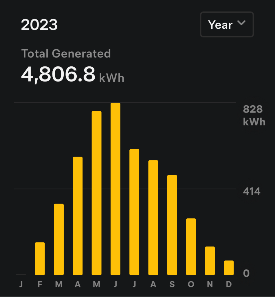

@ossify solar in manchester - despite common experience of low grey skies and endless rain, there’s enough sunshine to support solar panels. Our installation started producing late February 2023
Screenshot 2024-02-13 at 11.12.32

Posts: 13741
10
sunny Aberdeen 2023 with 10kw batteries
Posted : 13/02/2024 4:07 pm
kcal and kcal reacted
