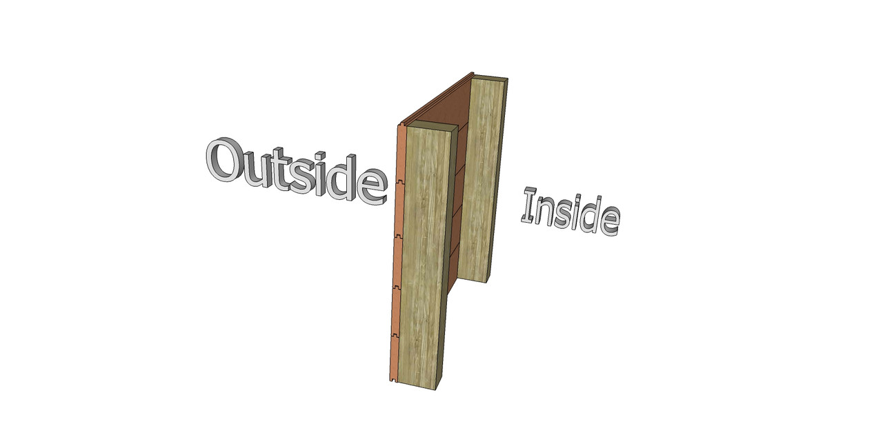

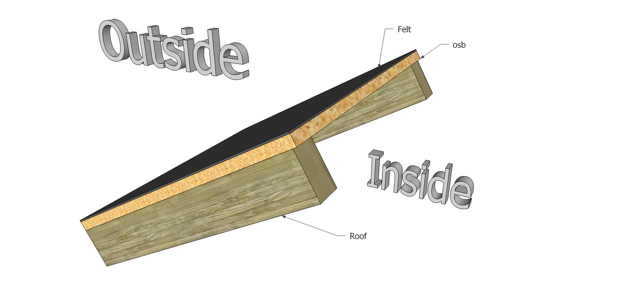

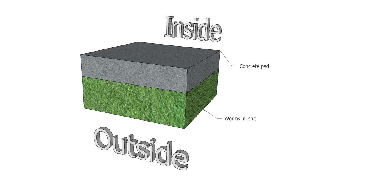

Just hijacking this thread a bit, hopefully for some agreement on the best approach for what I'm hoping to do.
I've got to partition off and insulate part of a large wooden outbuilding. It's a really well-built thing, on a concrete pad and I'm hoping to section-off about a third that will be used as an office. The existing double doors I will replace with modern aluminium glazed doors.
So, was hoping that some here may be able to comment on how best to approach each scenario as I'm a humble wood whittler and an insulation noob.
First off the floor. I was thinking I would lay joists down, then Kingspan type stuff between. Should I then fit a vapour barrier before I put down the chipboard/ply floor, or should the vapour barrier go right down first on the concrete before the joists even?
Next up are the walls. These are simply tongue and grooved cladding over the frame structure. What's the best approach here? Kingspan/foam board between but not touching the inside face of the T&G, then a vapour barrier, then line? Or do I not need a gap of any sort between the T&G and insulation? Or even, should the vapor barrier be against the T&G, then the insulation and lining?
Finally the roof. It's just a felt roof with OSB underneath. Same approach as the walls?
Sorry for the noobie questions, but it's something I've not had much experience with and don't want to make an expensive mistake! 😊👍

Cheers Paton, but that dude is building onto a timber suspended floor. Are you saying use the same approach for over a concrete pad?
Posted : 08/01/2020 10:35 am
On an existing concrete floor anything you do will raise the floor height, and reduce the headroom. So your options are limited.
The technique and info that the dude is using applies more to the walls and roof.
Posted : 08/01/2020 10:48 am

Insulating anything like this is about understanding how the reduction of heat and ventilation to some of the structure is going to affect where condensation will form, and what the longer term impacts of that condensation will be.
Kayak, your concrete floor doesn't need batons, nearly all PIR board is weight bearing, but you do need decent board ontop. DPM down,to stop moisture off the concrete, PIR down, seal the top joints, then lay 22mm chip board tongue and groove or 18mm ply. You underlying DPM should come up above the floor level in order to meet/join the wall barrier.
If you insulate the walls with PIR right up against the cladding, you risk the timber not being adequately ventilated on its back side, so it should really stand off. This might not be a problem depending on how much weather the wall gets, but how do you know? It would be quickest and most effective for heat retention to bash PIR boards straight across the internal frame and then board over, but you will loose interior space with this method.
Everything else is a compromise somewhere along the line, such as cutting and filling between frame members and then over boarding, which leaves more cold bridges but takes less of the internal space.
Posted : 08/01/2020 11:16 am
Not really an issue. It's a pitched roof so pretty tall. I imagine I could lose 50-100mm no worries on the floor.
Kayak, your concrete floor doesn’t need batons, nearly all PIR board is weight bearing,
Cheers. I hadn't realised that until now. Just watched a Restoration couple youtube that shows it quite well.
Posted : 08/01/2020 11:23 am
Its really the door height and if the door opens inwards that you will notice if you raise the floor height.
