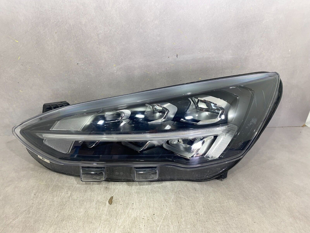

I’ve upgraded the main beam bulbs in my EcoSport, with some 5000k Philips bulbs, earlier this year, but one blew last weekend, so I’ve replaced both with some similar ones, can’t be arsed to check the make at the moment; the point is, high performance bulbs are expensive, and I’ve noticed that more recent Fords, like Focus, Fiesta, and Puma have LED’s fitted behind a projector lens, so I was wondering if it’s possible to retrofit those LED’s into the ones on an EcoSport, or something similar.
Don't think Ford use projector for LEDs, certainly my recent Focus didn't.
edit to add, pic of what my focus had
Posted : 17/11/2023 9:25 am
