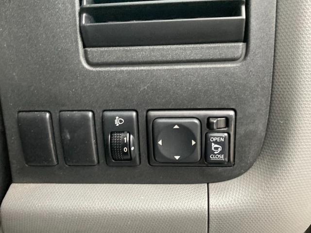

is there a fog light switch (or any switch) here? directly under the vent to the left of the four way toggle
Posted : 18/02/2022 9:47 am
Posts: 3171
A lot of cars only have one reversing and one fog light so completely fine to switch a second reversing bulb
It may be legal but its a pretty rubbish place for a fog light. Having one hanging below the bumper might look a bit rough but it is a good functional location
My Seat Leon is like that from the factory. Foglight on one side and reversing light on the other. I guess lots of cars are like that also.
Posted : 18/02/2022 9:57 am
It's kind of like this, only with just one blank switch port. There is nothing anywhere that looks anything like a fog lamp switch and I've twiddled everything.

Most JDM wagons are full of mad stuff, are you sure they’re isn’t a button that you thought just shot laser beams into the sky or something that’s actually the fog switch?
I was so excited when I found out that the final mystery button operates the parking-stick-with-an-led-on-thingy. The wiring was broken so I'd had 2 mysteries to solve but a quick fix and... stick goes up, stick goes down. Stick goes up, stick goes down. I watched it for way longer than I should have. Then I took a video and showed it to other people. Then I went round to my mates' place and showed him.
