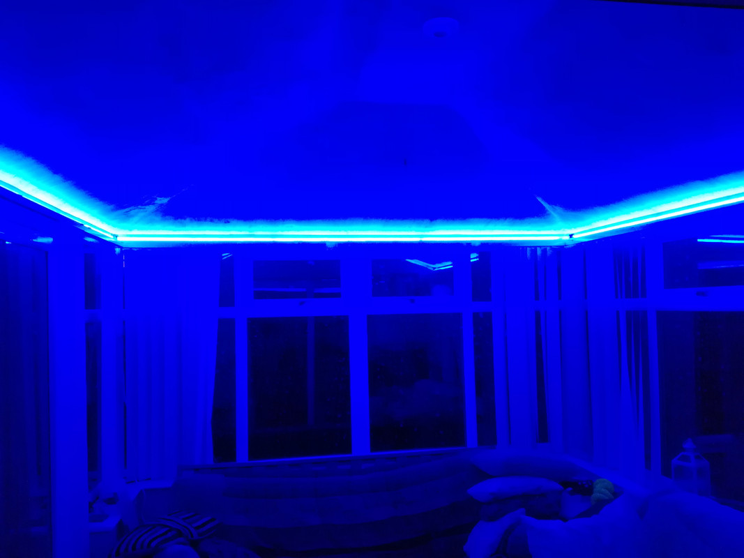

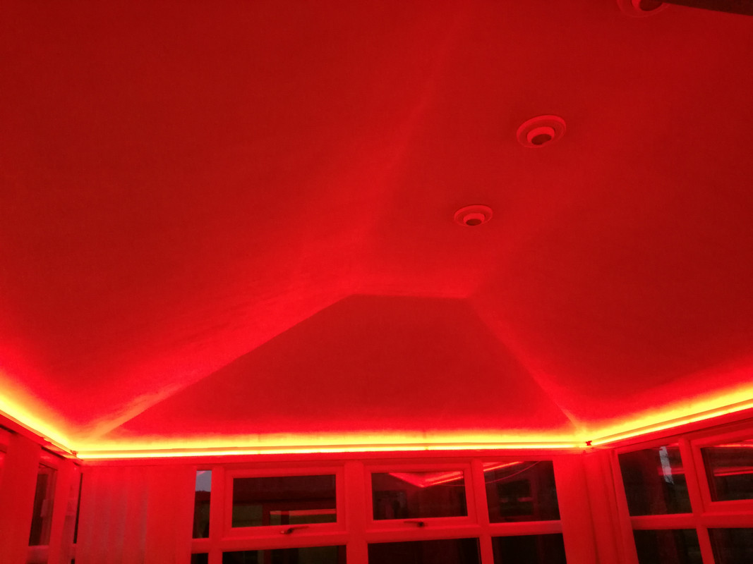

Bought some colour changing led strips online and built a rail for them to hide behind. Ceiling has had a coat of diluted paint. Needs a few more coats and the rail needs painting white. Sorry, only photo I have is red.

@matt the lights are usually soft white but I've been using the lights to teach my boy his colours. He loves changing them. Green is his favourite.

The LED strip light around the perimeter covers 95% of our lighting needs in ours and we’ve cut out 1/3 of the window space as well.
