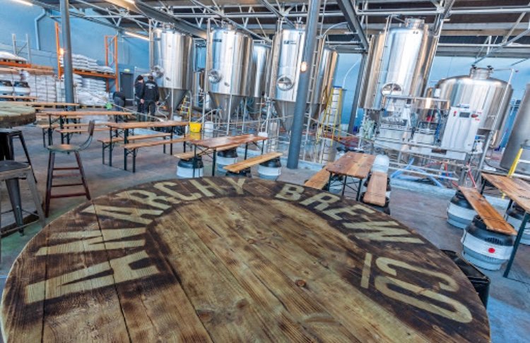

And yes, I am going to go commercial from here, though in a rather limited capacity
Around 7 years ago I met a couple in local pub with a similar set up. His dream was to do small batches of beer just enough so it would be job he'd loved.
Now it looks like this.
Posted : 15/04/2019 11:04 pm
