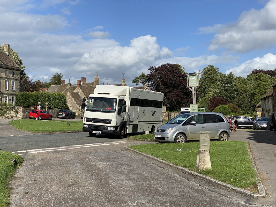

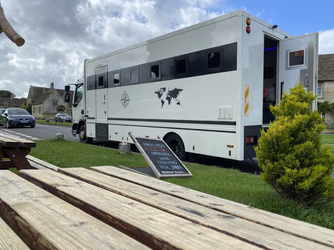

Actually, speaking of desirable campers, this was parked outside the pub I stopped at for a pint this afternoon after a walk, very nice bit of kit:
Anyone like to guess what it was in a former life?
Prisoner transport?
Posted : 05/07/2020 11:07 pm
Posts: 963
I have seen the wizzard wagon in real life and it truly is awesome.
I'll guess at a BT van.
