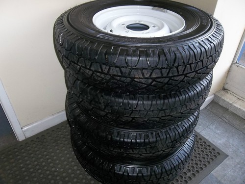

Posts: 91
I've got a couple of good Michelin Radial XZL 750 x 16 tyres on standard 110 rims if you want them for the cause. They've both got 9mm of tread.
I think 110s look great on standard rims. The only thing that looks better are galvanized 130 rims which are hard to come by.
Random search on Ebay yielded these new take offs.
http://www.ebay.co.uk/itm/Landrover-Defender-Michelin-lattitude-new-take-off-wheels-Tyres-x-4-750-x-r-16-/121269518106?pt=UK_CarParts_Acc_Wheels_tyres_Rims_Car_Wheels_ET&hash=item1c3c39ff1a
Posted : 04/02/2014 9:23 pm
Posts: 36
Wow, hadn't found those. They would look perfect wouldn't they.
They say they have a few sets. Not too far to get them either.
Posted : 04/02/2014 9:43 pm

Posts: 4892
Buy those standard rims!!!!! (Bin the the current chav go cart wheels)
Make me happy 8)
The latitude is a great tyre also 🙂
Posted : 05/02/2014 12:03 am
Posts: 6513
+1 for those standard take offs. 8spokes are naff.

Posts: 10980
Wow! I would go for those take-offs. If I still had my ex-MOD 90 I'd be tempted because my wheels were rusty. The 750x16 size looks perfect on a 90 or a 110 and I've never been in favour of fat tyres; they reduce your ground pressure and I've seen them build up a bow wave in very deep mud rather than cut down and through.
This pic taken after I'd hand-painted the wheels with Dulux Once in Ivory colour. It lasted surprisingly well.
Stoner, why don't you look around for a galvanised MOD front bumper with a towing pintle, as pictured below? This was galv, I just painted it black.
Posted : 05/02/2014 8:14 am
