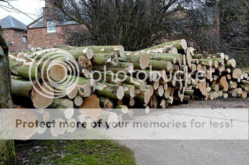

you'll end up like this...
Posted : 02/08/2011 6:12 pm
Posts: 1891
flumewelck
+1
My Aldi/Lidl saw did this lot last year and is still going strong
Posted : 02/08/2011 7:04 pm
