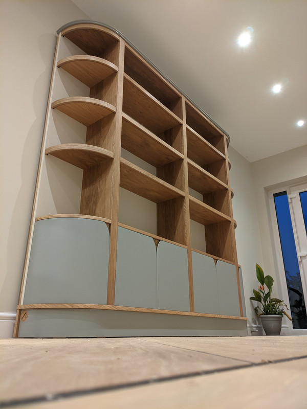

I have the Rutlands one and have done quite a few jobs with it including the base of this one here.
I think you can get very good results with it actually but like anything, there is something of a learning curve.
The paint I used on that above was Dulux eggshell, water based and thinned maybe up to 20% or so.
