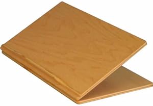

Earlier I meant to post an image of the previous "solution". It's something like below but attached to the chair. There are a few flaws with it though.
It's there permanently (20 min job to remove)
Getting him in and out of the chair is a pain with it on.
The CoB moves way forwards. On the verge of dangerously (not my USP 🙂 )
It's a physical and literal barrier between him and the world.
