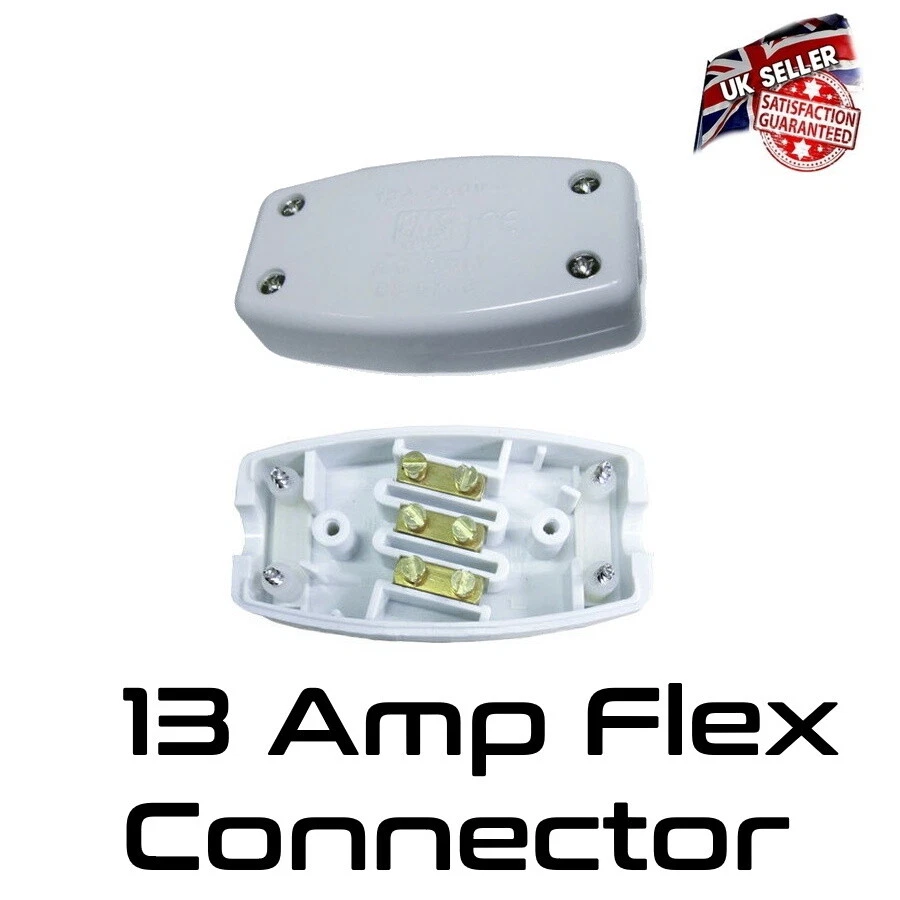

Flat two-core cable is available in any hardware store. Assuming you can get to the terminations in the sonos you can just replace it like for like. If not then you'll need a junction box. Wagos seem to be the connection of choice these days, you can buy the connectors (like 'choc-blocks' but better) and the small enclosure to put them in.
Although this would also work fine.

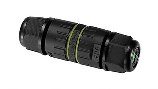

As above, junction box of some kind is what you need.  I used an outdoor type one like this as it matched the cable colour and is water resistant and slimline

Multi – where did you get that from? That's the sort of neat solution I had been hoping for!

The heat shrink + solder connectors are indeed brilliant witchcraft, for doing things like car wiring looms, but you'd still need some chunky heatshrink to cover them up afterwards and make it look neat (when making the joins, offset the cuts by the length of the heatshrink so they take up less space), the glue lined / waterproof stuff also provides a bit of mechanical strength so they can't pull apart.
But ....... with my PAT tester hat on, I'd probably say it's a fail because the insulation is still damaged and you can't say for sure that the repair is better insulated than the original. Whereas a connection box is easy to check.
