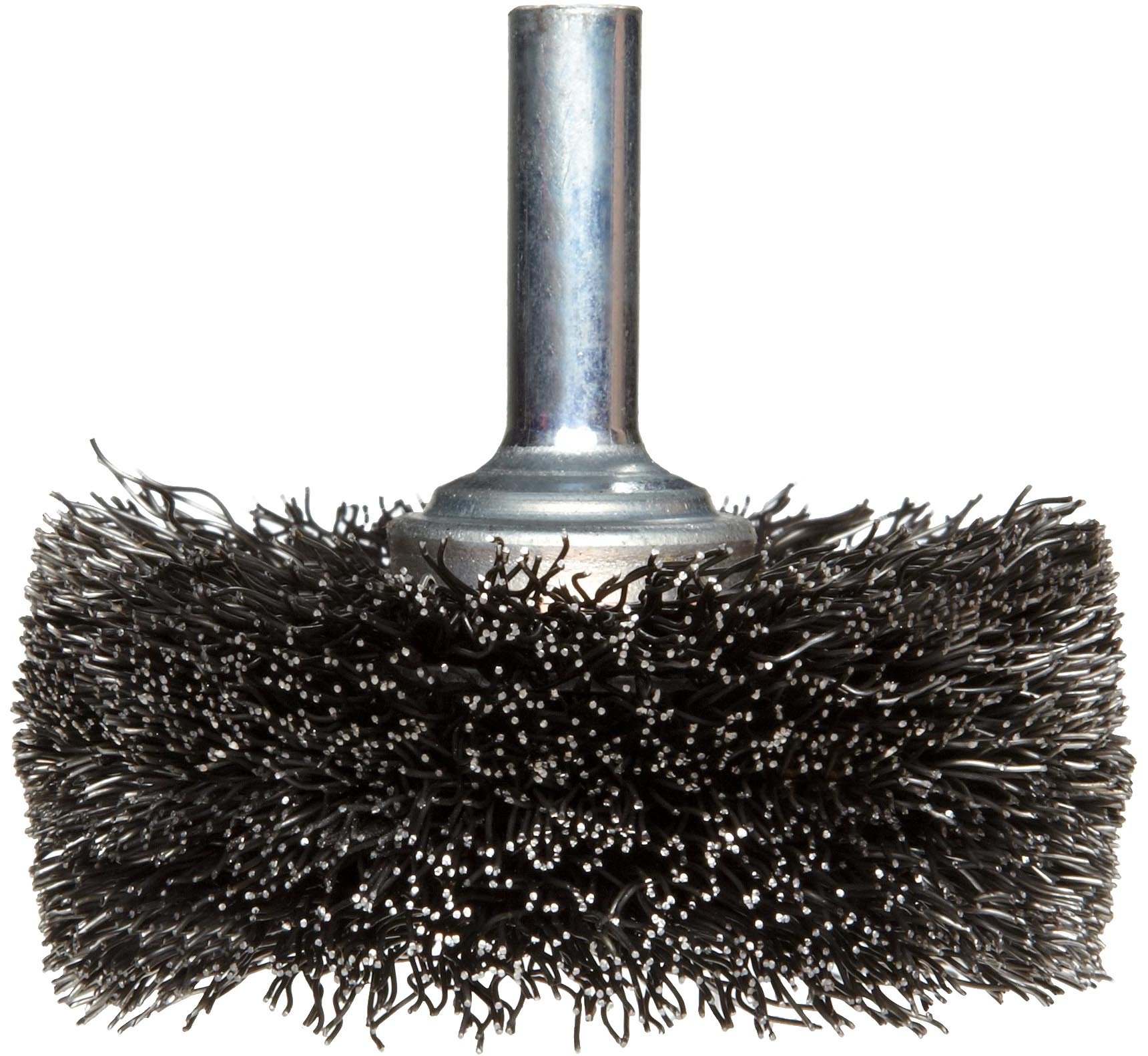

A wire wheel in a grinder would make short work of the rust.
I'd be tempted to visit the local plater's and see what finishes they can do.
Posted : 07/03/2015 8:46 pm
grinder with a flappy wheel for the iron, 120 grit or so, don't take to much off, then a nice oil. as for the wood, i think you'd struggle to get the shafts out tho, they are put in when the iron is hot and then quenched to grip tightly, and riveted, maybe just a sand and an oil?
I'd actually go for a cup brush in a drill, a grinder can be a bit too eager and you'd loose the character of the metal - the torq and momentum of a heavy brush spinning that fast makes them difficult to use with accuracy. With a grinder you'll also be picking bits of crimped wire out of your clothes, hair, teeth and pants for weeks. There are also disks of 'non woven abrasive' that are gentler than cup brushes and remove paint and rust without digging into the metal
