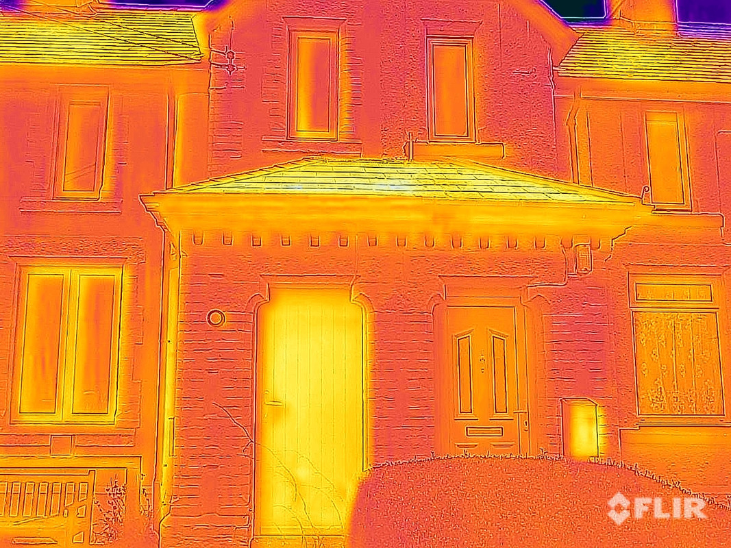

i borrowed a infrared camera from work and it's interesting viewing. found one bit cold patch upstairs where clearly there is a area of insulation that is missing or been moved. about a metre square was ~3deg cooler than the rest of the ceiling. you can also 'see'  a cold draft coming in under the front door and where it goes.

these really are useful. spot the cat...

And from the outside. My neighbours plastic front door and windows look horrible but it’s far more insulated than my very expensive accoya front door and windows..

Yes I re-insulated the loft 600mm, plus used a thermographic camera from work to eliminate as much of heat loss as I can and I have to use a dilute bleach mix on the ceilings of various rooms upstairs every so often.
Its a small price to pay for my low energy bills
Posted : 13/03/2022 3:54 pm
You shouldn't be getting condensation on the ceiling with that amount of insulation on top unless it's cold spots amongst the insulation due to poor placement or your loft is very damp due to eaves blocked up and it's dripping down through the insulation onto the ceiling. Perhaps take a look up there where the mould is forming?
