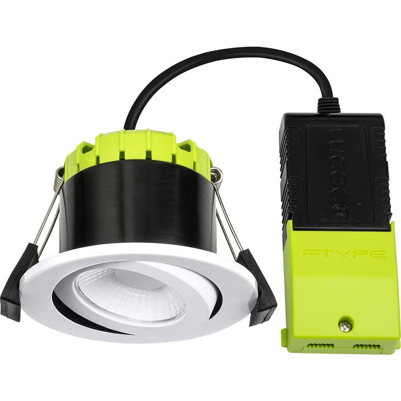

I'd have thought the inner ring would pull out leaving the outer plastic hole cover behind, you then un plug the light fitting and fit a new one.
Should look something like this when you get it out...
