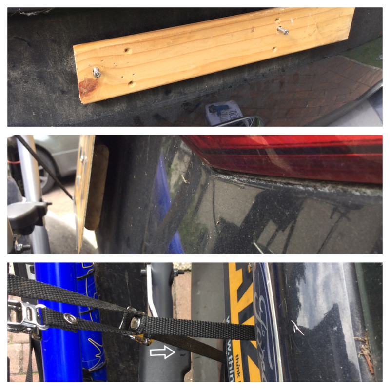

I’m paranoid about my bike on a tow bar mounted rack.
The bike is never going to fall off the rack , I just don’t trust something gripping a ball.
So I’ve thought of a bit of wood (might be metal once I’ve gone to a mongers)  screwed to the number plate bolt holes so that I can attach a strap to stop any potential rotation away from the car.
Will the nuts just pull through going over bumps or do I need to put some nuts and a bar inside?

The issue is probably not the rivnuts - but whatever the number plate is mounted to - 50g v's equivalent of several kg of force. Even a fairly solid bit of bar is pulling on some flimsy metal/ It would be very easy to bend stuff on my car. Even if yours seems rigid - do you turn a simple dunt of the rack on a bollard, high kerb, low wall etc into a new back door?

I wouldn't trust the number plate fixings - not without spreading the load on the inside of the tailgate even then it's still only sheet metal and will flex. The manufacturer never designed that panel to take a load like that. Towbar is a far better bet.

I have attachment points all over the inside of my van on rivnuts. Managed to pull one out splaying the steel skin. Number plate attachment would be similar.

Your instinct is wrong. IF it did go arse over boob a couple of wee rivnuts will turn into bullets when they get ripped out a fraction of a second after.
