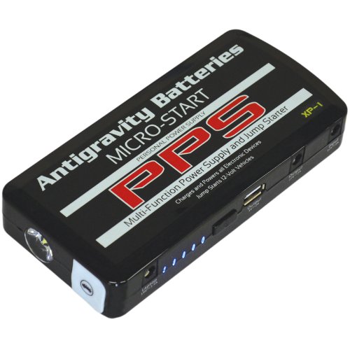

Forget AA's what you need is one of these.
[url= http://www.amazon.com/Antigravity-Batteries-Micro-Start-Multi-Function-Personal/dp/B00FDYYK4A ]Anti Gravity Jump Starter[/url]

Slight thread revival - that Anti Gravity Jump Starter, does anyone know a good price for one or an alternative in the UK, as they're massively pricier in the UK compared to the States, and I'm also not sure if the mains charger would be UK-compatible.
I'd like to get one as a present for someone, you see.
