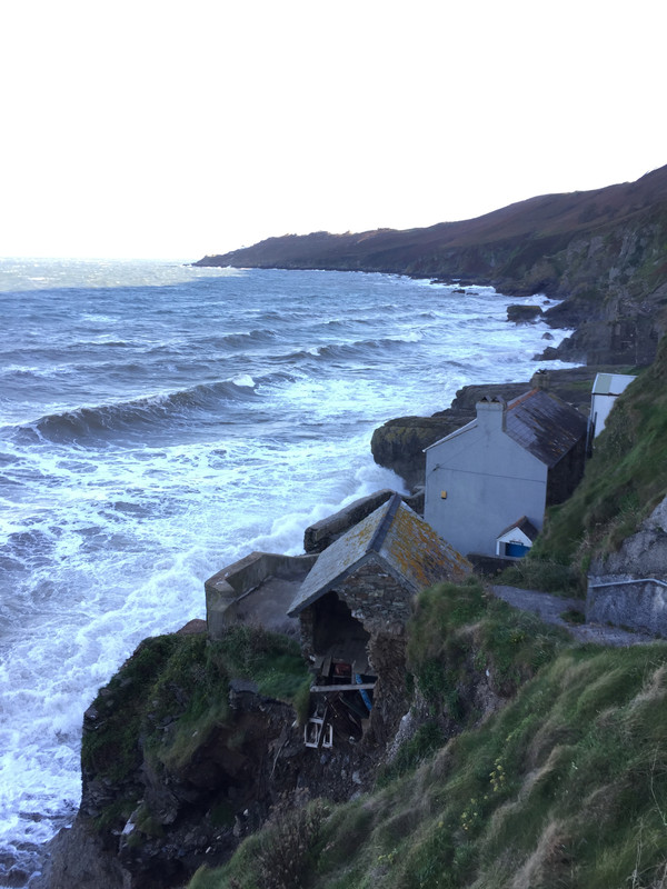

I’ve personally seen how things can change with rising water levels, although due mainly to human interference, one being the flooding of the Somerset Levels a few years ago, because a government Environment Agency bod decided that the local rivers shouldn’t be dredged to allow ‘re-wilding’ of local farmlands, despite the area being the result of measures taken by monks 1000 years ago, so farms and properties ended up under water for six months. Dredging eventually took place, and there’s been no significant flooding of the area since.
Coastal erosion isn’t so easily dealt with, and features that may have ameliorated storm damage but were altered by humans just can’t be replaced. Thirty-odd years ago I spent holidays in south Devon, in a little village called Beesands. Along the coast is another village called Hallsands, and the beach extended below a group of ruined cottages built on a rock shelf about ten-twelve feet above the shingle, it was fairly easy to climb up and explore the ruins.
Fast forward to a few years ago, and I couldn’t believe the change to Hallsands - the beach had gone completely, instead there was a vertical wall of rock into about ten feet of water, and most of the ruins had gone.
Last time I was down there, after further easterly storms, I took thes photo of one of the two remaining cottages, this one called ‘Sea View’, where you can see the damage to the small outhouse/garage to the side.
Rising sea levels and longshore drift caused by the dredging of the shingle banks called the Skerries out in the bay to build Devonport dockyard in the late 1800’s have conspired to cause the damage, and it’s not going to stop.
https://en.wikipedia.org/wiki/Hallsands
Posted : 13/02/2021 7:11 pm
Fast forward to a few years ago, and I couldn’t believe the change to Hallsands – the beach had gone completely, instead there was a vertical wall of rock into about ten feet of water, and most of the ruins had gone.
@CountZero - I've stayed in one of those cottages in Hallsands, also about thirty odd years ago! One of my Dad's friends owned it so my Dad used to take me and my sister there at half-term or summer holiday. As you drove up to the pub there was a steep set of steps and then a footpath along the front. Even then the cliff edge was only 15ft the other side of a flimsy wire mesh fence. The second year we went the cliff edge was noticeably closer...
Looking at Google Earth now, I don't think that line of cottages is there anymore although I can't be sure, it's not the best resolution images.
Posted : 15/02/2021 9:39 am
