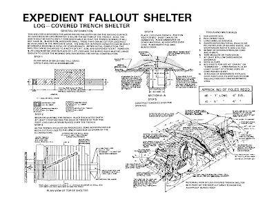

Crazy to fill it in - you never know when you might need a decent hole in the ground:
