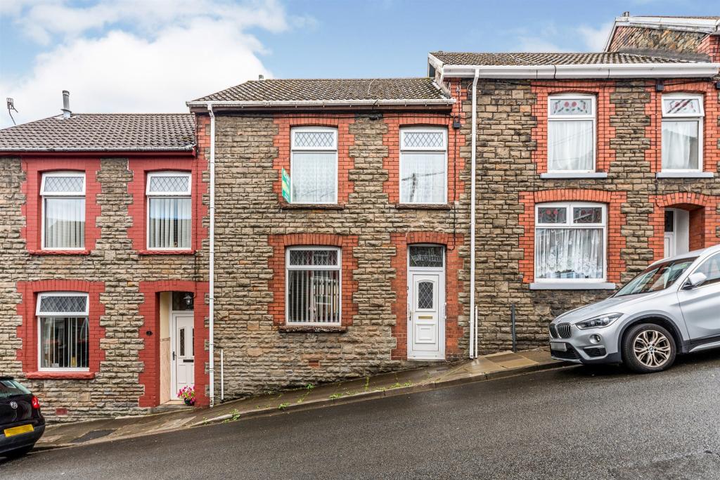

Viewing this tomorrow, it's priced a bit high but in a decent enough area by me
Needs work, budgeted 5k for kitchen all in and 4k for bathroom
What are the obvious money traps?
Damp / mould
Electrics - is there an easy way of spotting if re wiring is needed?
Can that artex be skimmed over?
I'm no builder but looking to live their rather than flip it, wall paper and tiling I can sort myself
Any tips?

Ooft that bath is minging!
Looking at it and how old the decor is it may need rewiring. Kitchen looks fairly new so they may have done something in there. If the consumer unit is new it may have been rewired already.
We had artex skimmed over, it didn't cost any more than normal.

Nice location. House looks pretty solid from the pics. Try and get a view of the roof from both side. Looks straight and in good order in the pics, though. Is it elevated at the rear? Should be fine for damp if the roof is OK. Structure looks in good order too, but look for cracks, especially around the windows and have a wander down the street and see if all the others are OK too. Why have you budgeted for a new bathroom? Joking, obviously needs a complete make over but that's all achievable. Other things to check are the paperwork. Is it actually freehold? Is there any weird access over the land? Is it over an old mine?

I can tell you now that you'll probably want to allow for rewiring. Looking at that house it's a very long time since anything was done and while the wiring may be perfectly safe I expect you'll find there are no where near the number of sockets you'll want or need.
Artex can be skimmed over, it's quite likely that the artex in that house contains asbestos as is the case with I would guess hundreds of thousands of other houses. I know for certain that mine does. Just something to be aware of if you are making holes in it. And the paint may well contain lead. Before I was aware of these things in a previous house I tore down 2 ceilings that were artexed, scrapped the artex from all 4 walls of one room and stripped god knows how many layers of paint from 130 year old woodwork. One day I might end up regretting that!
Edit - the nothing being done for years is a good thing in my mind, in my first house half the work was undoing the bodged diy of previous owners - actually probably one owner, it all looked like the work of a single idiot! 😊

If there is any damp you will be able to see it pretty easily given it doesn't appear to have had any remedial work done to hide it. It is mid-terrace so probably only going to get issues front and back. The front is paved so water may not drain away so potential for damp around the front window etc. The garden appears to slope down so water should drain away okay on that side. Also look around the chimney breast areas - the adjoining property appears to have a chimney but this one doesn't so it may have been removed (which seems odd, but I have seen odder things happen).

With a house on a slope the back (high side) is your potential damp issue - get a damp meter and check it.
Roof tiles are clay and fairy modern - def not original, so the roof has been done at some point. Clay tiles are heavy & sagging can be an issue/red flag. It looks good and straight.
Id say it looks in decent condition, just dated. Don't forget how expensive skips are these days.

I'd assume a re-wire and new boiler. The kitchen may be on a new consumer unit but everything else may be on legacy wiring. The radiators all look ancient.
Don't re-arrange the bathroom, it looks like its making the best use of space so you can just swap new with old units, keep tiling to a minimum to keep costs down.

Windows look like they do not allow safe exit in case of fire. Big fixed pane and small opening pane.

Definitely needs a rewire, the sockets are mounted to the skirting board. I would also be checking and asking about the work done when the walls were knocked down. Photo's 2 and 5 show where the wall was originally so need to check the work was done properly especially if it was structural.

Just viewed, don't think the EA thought I was serious and couldn't get me out quick enough, three builders have already viewed with offers over 110k in already, sellers hanging in as it only went on on weds
Ceilings are mostly polystyrene tiles so can be stripped, EA quoted rewire at about 3k, there's two areas of flat roof at the back that'll need to be stripped and re-done
Builders were quoting 30k to modernise, I've been looking at a max house cost of 150k all in and had recently put an offer in a finished place with a nice view for 153k - turns out planning for a 4 bedder had gone in opposite so I pulled out
Still tempted to put an offer close to asking in as houses in the area are going for 160 plus, I have the weekend to think about it...

If your parking out front, make sure your handbrake is good and turn the kerbside wheel inwards 😉
https://media.rightmove.co.uk/64k/63584/72919605/63584_PPD304257_IMG_03_0000.jpg

It looks like it has been squeezed hard to be converted to a 4 bed. I'd be tempted to make it a nice 3 bed. Put a proper bathroom upstairs at the back and then either open up the kitchen/bathroom to a bigger kitchen or convert the downstairs bathroom to a utility and loo. Upgrading the lean-to to a nice summer room will be good. You could put a new back door into the kitchen space then block up the existing door and put a door in from the lounge.
Plenty of room for a nice shed too.
