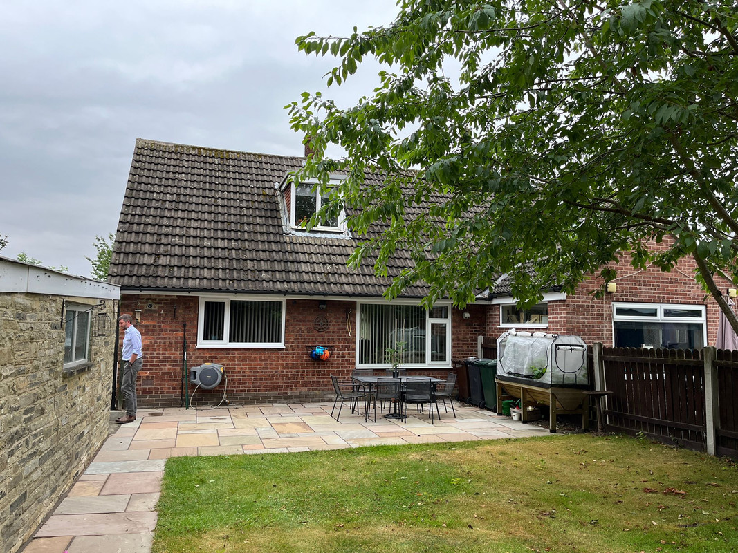

Need some advice on a possible new house purchase and down the line an extension.
Looking at a semi-detached house and plan to build a single storey extension (well, may be two storey but unlikely) not un-similar to the one neighbour has.
Couple of photos below from the garden/patio of the house we may buy.
Garden
Garden 2

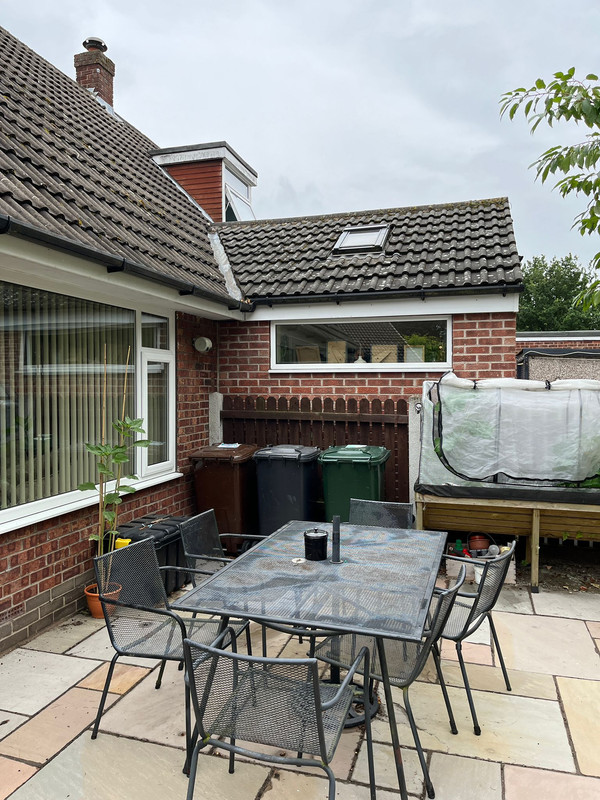

As you’ll see (if I managed to post a photo) the neighbour has a side window on their extension that looks into our possible patio. It’s likely if we built something that window would be blocked.
In my mind we’d not get permission, is that likely? I’ve also got a little voice in my head saying they knew darn well the neighbour may also build something similar and sod them.
Has anyone had a similar predicament? Is the window there to stop such extensions?

Looks to me like they've built right up to the boundary.
It means you might have to come into your boundary by some distance so that your new ridge line meets the 45 degree rule (if that's what it is, I forget now).
It might have been placed cynically. It does completely knacker your chance of a party wall.
That said, it might not be legit. I would investigate whether they should have put a window so blatantly overlooking your plot.
My parents neighbours had to remove a window from their extension for that reason. But. Didn't exactly do wonders for their relations with the other neighbours involved...
Posted : 21/07/2022 2:09 pm

They've got a rear window and a skylight anyway..
Is there another window on the other side of the extension?
Bit of a cheeky chancer if you ask me... By doing that they've effectively prevented you from doing the same which seems out of order to me so I'd be supprised if you weren't allowed to block that window off.
I'm No expert on these things though.
Posted : 21/07/2022 2:10 pm

Neighbour appears to have already blocked their window with photo frames.
My guess is that the plans said frosted / obscure glass but the builder forgot or couldn't be bothered.
A quick perusal of the local authority planning portal should answer that.

That window looks like its supposed to be high level, to try and dodge overlooking issues. Planning would not approve a window looking directly over a neighbouring property like this and it would normally only be possible if it could be proved it didn't ie too high too look out of (ie clerestory) or obscured. Or you prove theres a 1.8m or 2.0m fence or hedge forming the boundary so any window looks at that. This window is effectively on the boundary even if its 100mm behind the actual line. Therefore that window would have no right to light/view etc if you built an extension you could effectively ignore it! Heights of extensions on boundaries is dependent on PD rights if going down that route and orientation etc if not there is ample guidance on most councils websites to determine the rules as they would apply to your case.
I would also imagine that extension has been done under PD rights and they maybe asked the original owners if they minded and they said no.... either way its a particularly thoughtless piece of design.
Not sure when that extension would have been built (looks 80/90's) but you certainly couldn't do it now.

Looks like their gutter and valley is already discharging into 'your' gutter? Any agreements in place for that?
Posted : 21/07/2022 2:45 pm

It would also appear their extension wall foundations go into your property? Do they have permission for that? This is a good one for your arsenal.....

Looks like their gutter and valley is already discharging into ‘your’ gutter?
Is this not quite normal on a semi-detached house ?

AndyKirk I think will know better but i think technically there should be two downpipes connected to a shared surface water drainage via *i think* connection chambers to allow isolation at each property.
Posted : 21/07/2022 6:22 pm
Posts: 1725
As someone else mentioned the gutter and valley going into your gutter doesn't seem right at all when it could have fed out into their garden easily. It looks like they have taken the owner at the time for a ride on this along with the window issue.
How big is the gap between the fence and their wall? Your extension would have to match that gap I expect, then they would have to sort out their valley and gutter as you would have a mirror pitch yourself with your valley and gutter correctly draining out past the extension to a soak away in your garden.

Looking at the window in the extension I don’t think I’d be too keen on having them as neighbours… too high a risk of conflict in days / months / years to come
Walk away and find another to buy
This 100%.
Assuming they are the people who built the extension - this doesn't pass the dick/idiot test. Whether they are either idiots or dicks, they are clearly hugely inconsiderate. Why on earth would somebody think it's acceptable to put a window there?!?!
Even without an extension, first thing you would be doing is either asking them to remove/obscure it, or putting up a fence/hedge directly in front of it with the express purpose of blocking it. This is going to put you in conflict with them from Day 1. In their eyes, you will be unreasonable one..... after all: if they understood why the window was problematic, they wouldn't have put it there in the first place.
I'm a bit triggered by this as I have a neighbor who's hobby is trying (and usually succeeding) in causing conflict between herself and her various neighbors. She has mental health issues - but she's also an extremely nasty and vindictive person. The sorts of things she's done would blow your mind. This sort of red-flag would have me running for the hills.

I used to own a house with this exact set up, with the neighbour having newish brickwalled conservatory with a window just like that. It was built about 100mm back from the boundary. Our garden was about 50cm above theirs. It was a pisstake and built when our house was rented so presumably they got away with it.
The problem was if I wanted to build something the same there would be an inaccessible gap between the buildings, and I would have to modify the foundation for their conservatory. But because it was slightly stepped in on their side there was no possibility of extending the party wall and making a tidy looking thing. So really the only feasible thing would be to step in a lot more on my side which would render any extension less useful. I discounted it before I bought the house.
The neighbours were generally pretty cool but the conservatory was very definitely their most precious room. To be fair it was a really smart thing with wood burner, music set up etc. Once I got to know them I'm pretty sure if we interfered with that it would have been a declaration of war.
If the house is only good to you with an extension on boundary I'd be careful. Life is too short to fight with your neighbours and that has conflict written all over it. Either that or buy it, have the conversation and then decide where to plant you leylandii and bamboo hedge.

Posts: 4593
Cheers all for the replies, love this place.
Our council planning portal has everything on from 1980 onwards and no note of this wee addition to be seen. I suspect the seller may be wrong on the construction year.
I'm popping over tonight to have a chat with the neighbour to asses their dickish levels. May even bring some pre-emptive frozen sausages if they transpire to be prize throbers.
Posted : 22/07/2022 9:28 am

Posts: 17728
Perhaps not particularly relevant to the larger conversation regarding whether moving there would be a good move or not/neighbour disputes/planning etc, but regarding the location of that window specifically...
It looks quite high up the wall. My sister has a similar window in their living room, which overlooks the side of their garden that wraps round the house. It lets light in, but you really can't see much out of it, as it's too high.
To use it as a lookout to keep an eye on the neighbours, they'd probably have to stand on a step for it to work.
It's probably just a window to help let in light & when viewed from their side, probably doesn't actually provide a clear sight-line onto that patio.

Posts: 16346
It’s probably just a window to help let in light & when viewed from their side
That would seem more likely than
putting that window in purely for the purpose of blocking anything you wanted to do

Posts: 4400
If you're lucky they'll be perfectly reasonable and knew from the outset that putting a window there was risky, and that if someone in the future had the same idea as them then they'd have to suck it up.
However, they may be unreasonable and see it as their entitlement as they got there first, and you'll be stuck next to them forever.
I'd chat to them now before doing anything more.
Even if the window falls foul of planning, is that a road you really want to go down with neighbours that will object to your extension because of a window that probably lets in marginal light now?
