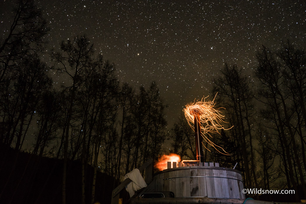

If you're going to do it, you really need to do it in your own private cabin in the mountains and ski from your door like [url= https://www.wildsnow.com/18194/backcountry-wood-fired-hot-tub-improved/ ]Lou[/url].
