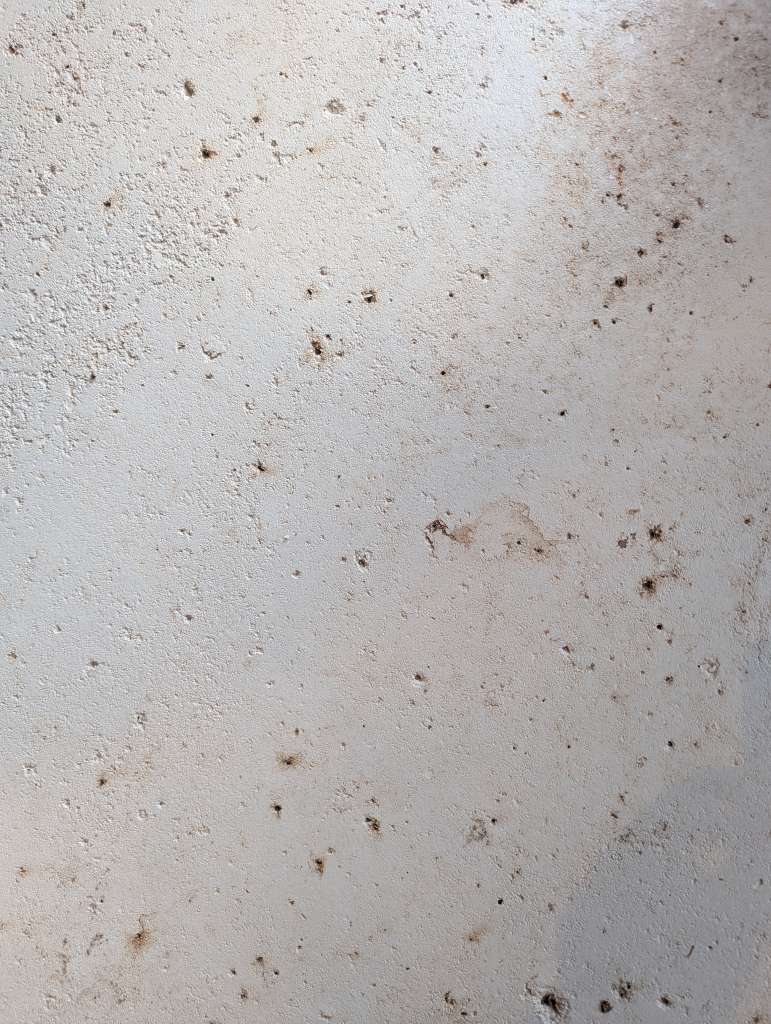

I painted my concrete garage floor and it's crap!
Initially it was bare concrete so I sealed it with PVA before using Leyland heavy duty floor paint. I was hoping for a nice smooth finish though you can see in the photo that's not what I've got -  You can still see the concreate texture through the paint.
Not only this but when I clean it with a standard home floor cleaner it seems to chemically react somehow. I'll get a sort of brown residue leaching out which causes more pitting and makes it look worse than before I mopped!
Does anyone have a suggestions / experience with what I should use to repaint it with? Some sort of epoxy based paint maybe?
Cheers all

Epoxy will give you the smooth finish and be mega hard wearing but is mega money vs just buying a tin of paint. Best thing I did was cover the floor in those foam tiles. Dead easy to fit and keep clean and feels loads warmer and quieter. Bought a few packs off Amazon for not a lot of money.

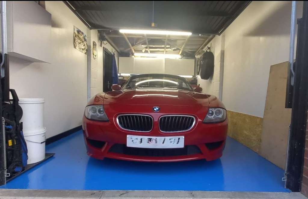

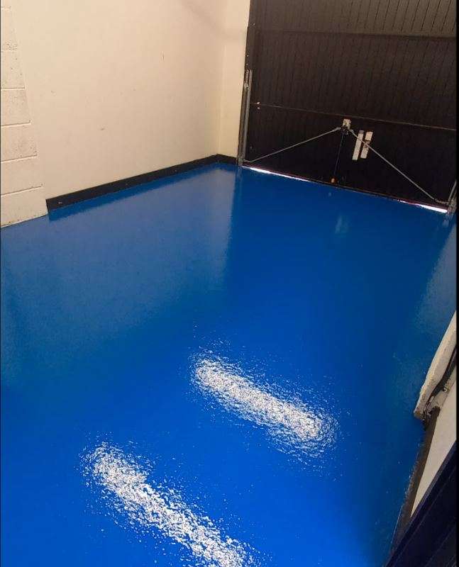

You'll never get that 'smooth' with paint - itll need a grinder/polisher to acheive that.
However a proper high build epoxy type paint will be much better and closer to what you want - You need proper two pack stuff. You've probably made your life more difficult by already trying something - I'd speak to these guys and see what they reccomend in terms of prep over the old stuff.  Bear in mind its a full weekends work pictured, not just a quick roller out from a bucket.
https://regalpaint.co.uk/single-garage-two-pack-garage-floor-paint-bundle/
This stuff worked great for me, and this is a proper 'garage' too - hot tyres, axle stands, jacks, nasty chemical spills etc.
Cornflower Blue, in case you wondered!
You can see its textured but its relatively smooth, and every few months I empty it out and mop it all and it comes up lovely and shiny.

If epoxy, you're going to need to strip off all that other finish and sealer.
You're grinding and peeping if you want a decent liquid applied finish otherwise whatever you apply is only as good as the bond of whatever's below it
The cost of epoxy is in the cost of the process, not just the materials.
