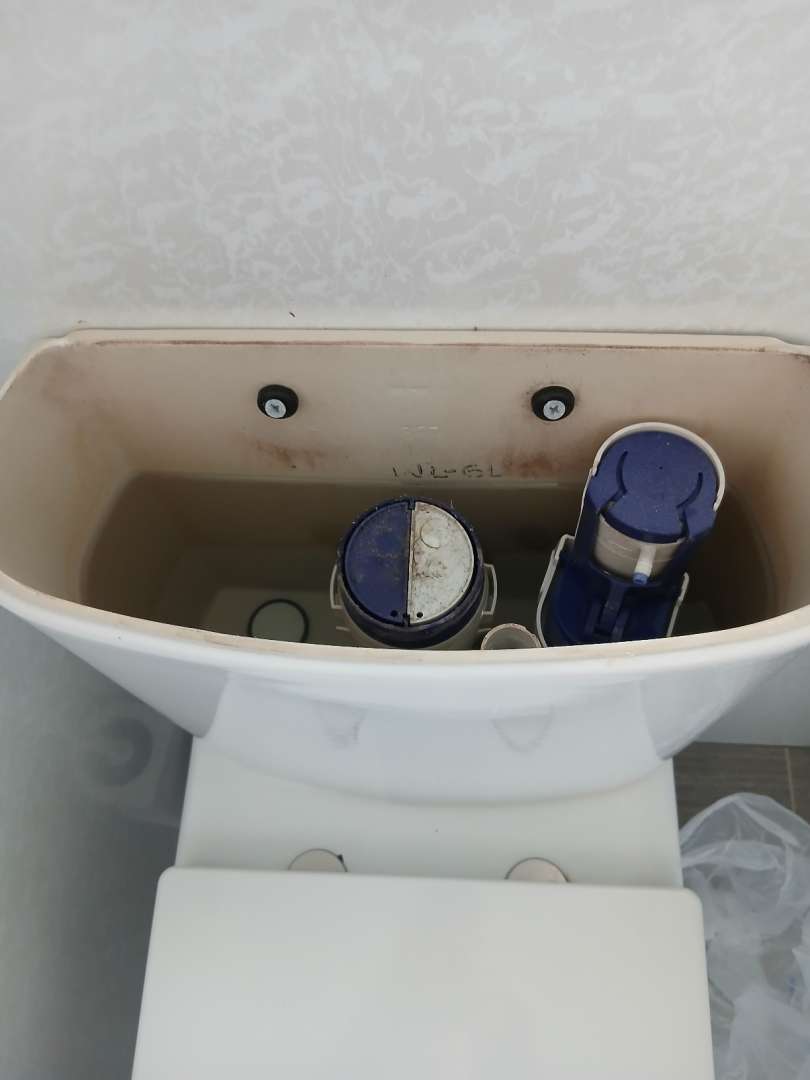

I have just replaced a Fluidmaster dual flush valve so can speak with some authority on this.
Small button inside big button. All the small button does is stop the big button being pressed 'too far'. The big button fully depressed is the number two button. There are sliders on the valve to adjust the one/two volume.

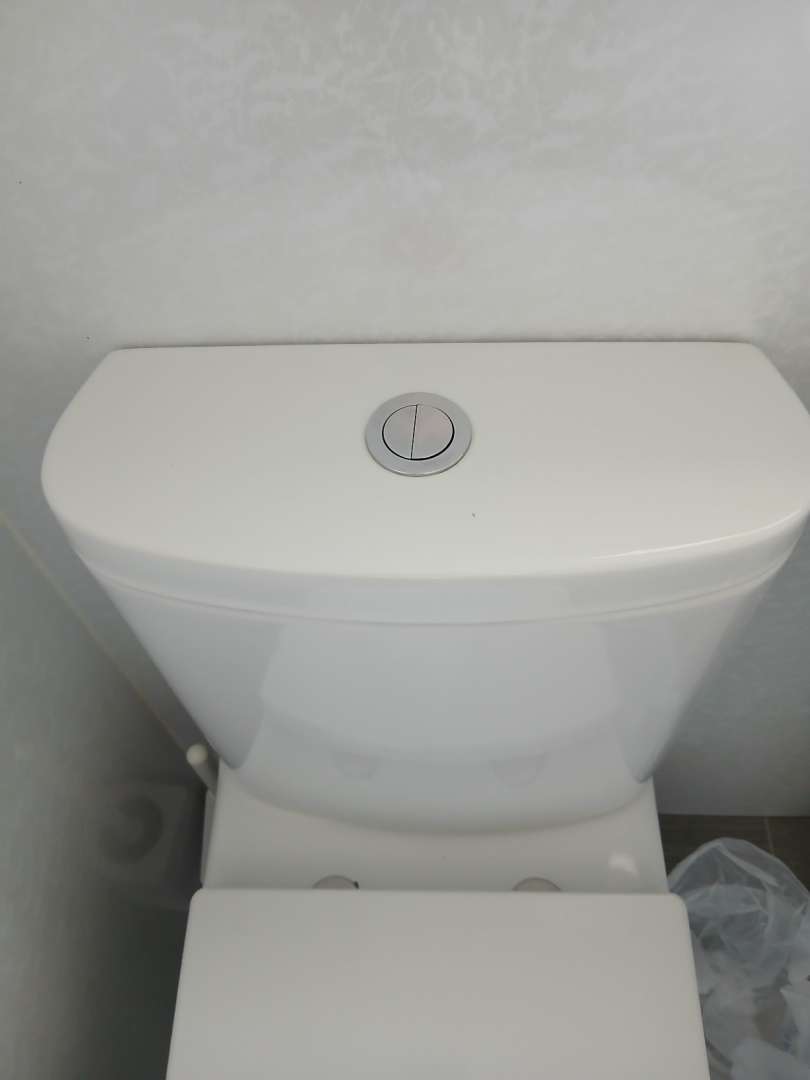

I'm in a holiday let in Scotland, and in the interests of detail, have just whipped the lid off this cistern for a look.
Two parts to the top button, one slightly bigger than the other. Smaller button produces a quick flush by activating the blue part, bigger one produces a longer flush activating the white part, which seems perfectly logical. Pressing both, I guess, would only produce the same result as the bigger button, judging by how far the water level dropped in the cistern.
So on the basis of a sample of this one, I'd agree with OPs assumption that his ain't quite right. But the design may be different.
Cistern and lid made in UAE of all places. Who knew they had a loo-making industry there? Anyway, that's not so relevant.

Posted by: thelawman
Yep, this is kinda what's going on. The siphon in the cistern has two 'halves', one activated by the big button on the lid, the other by the small button on the lid.
Taking the lid off and pressing either half of the syphon directly produces a number one flush. Pressing both together produces a number two flush.
The buttons on the lid work completely independently of each other.

That sounds like your lid & buttons are similar to the ones I'm looking at, but the mechanism inside the syphon is different. Activating these ones here by hand definitely produces different sized flushes. You either need a different syphon, or just accept pressing both buttons for a twosey.

I've just looked at the two toilets here.  They both have the same two-button flush (branded K-VIT) but rather than an outer button with a tiny inset one (where the inner button is clearly only meant to be pressed along with the outer) it's more like a crescent moon and an almond so it's less obvious as to which is which.  Similar to the pic below, only in a less gopping finish:
Both pairs of buttons appear to operate the same design of flushing mechanism. The two halves each have a rod which pushes down one of two plungers on top of the syphon (very similar to @thelawman's photo above).  The white plunger is as close as makes no odds a full flush, whereas pressing the blue one there's an audible 'thunk' when the water level drops to about 3/4 so I'm guessing there's some sort of (adjustable?) stopper valve within the blue side.
Here's where it gets curious. The mechanisms in the two bogs are mounted at 90' from each other.  Ie, one cistern has front & back buttons and the other left & right buttons.  Whether this was due to some plumbing / physical space restriction or simply how they happened to get installed I have no way of knowing.  But whatever the reason, they are functionally opposite.  On one bog the blue plunger is plunged by the almond button, on the other it's plunged by the moon button.  So whichever way round it should operate, one of them is wrong.
