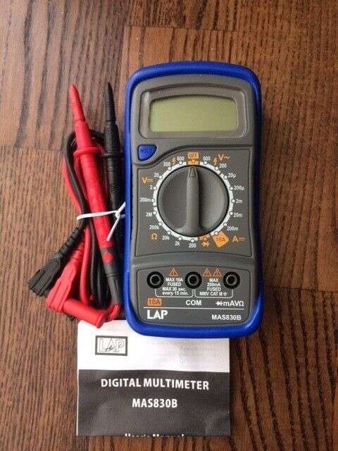

i also have a multimeter, one of these, but no idea how to use one 😀
multimeter
anyone care to walk me through anything to try?  settings on the multimeter across various wires etc?  i think ive taken everything off that i can so cant delve any deeper, although that doesnt mean ive missed something.

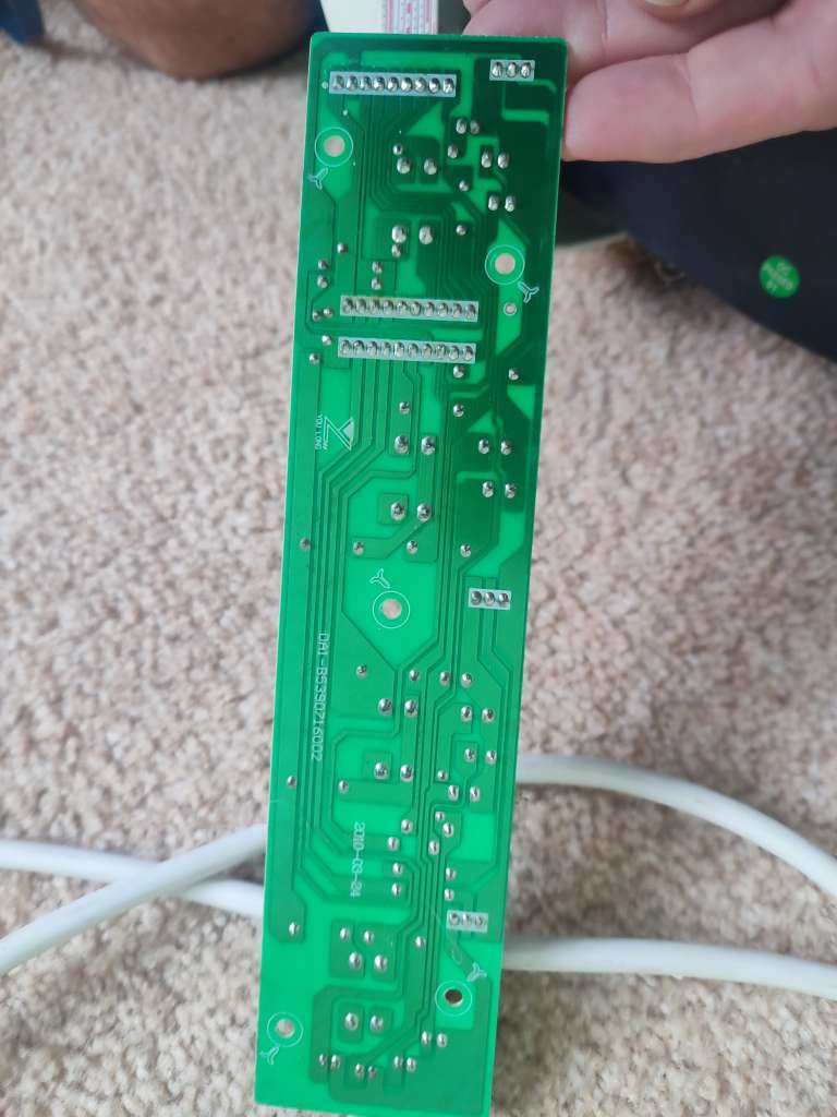

Posts: 4313
Could you post pictures of the circuit board please? Might be easier to draw on a picture than try to explain.

Posts: 7423
certainly, here you go....

Posts: 4313

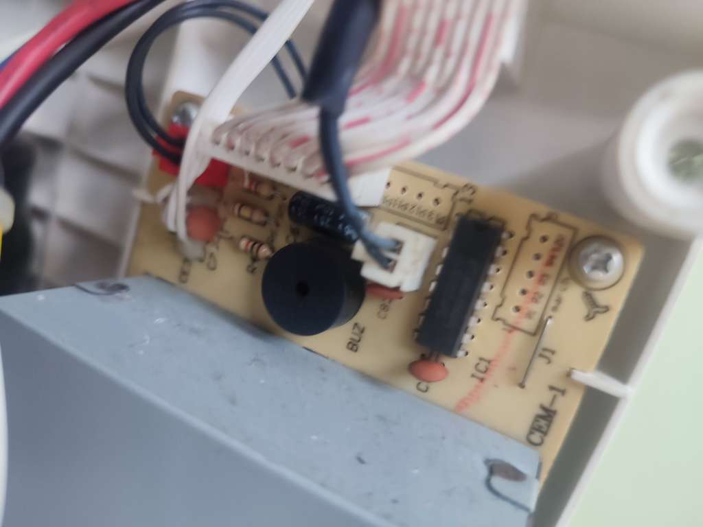

Nothing obvious in the photo, interestingly I can't see any capacitors on the board although the photo's a bit blurred at the top - can we have another photo and one of the other side too please? The thread linked above suggests a fuse, I can't see any in the photo either.
What's the other end of the ribbon cable connected to? More photos please!

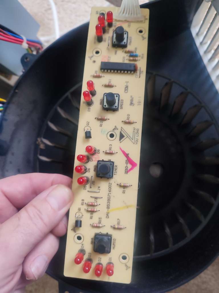

Posts: 7423
as promised, both sides of circuit board from the top of machine, and a pic of the board it leads to....
IMG_20231008_100627
IMG_20231008_100636
IMG_20231008_100724
