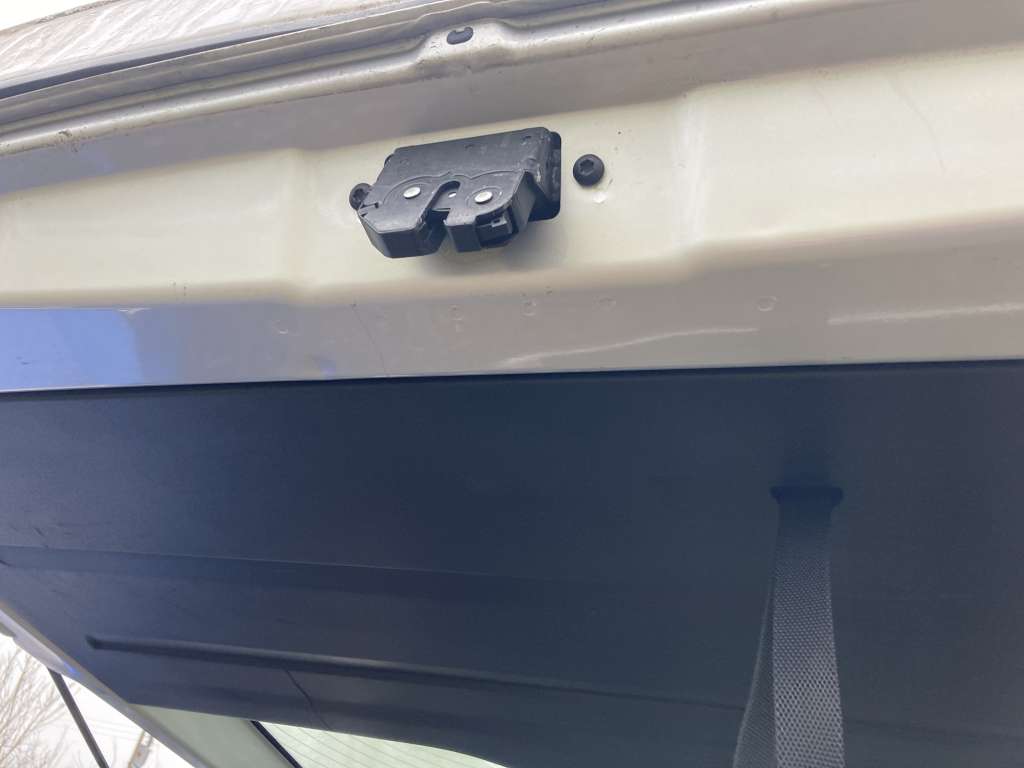

Is there a hole in the latch that you can shove a screwdriver in from inside? Most cars have an emergency release like this, but Doblo may be different.
boot latch

Thanks @pocpoc there was a hole in the floor that I could open it with. Actually useful to know as we use this as a micro camper.
IMG_2090
Looks like I will need to take the big plastic door trim off the inside to fix or replace the lock though as it still won't open from the outside
IMG_2094
I will see if I can jiggle it out through the hole first and have a look at the lock and connection. I will have to wait for this storm to pass though

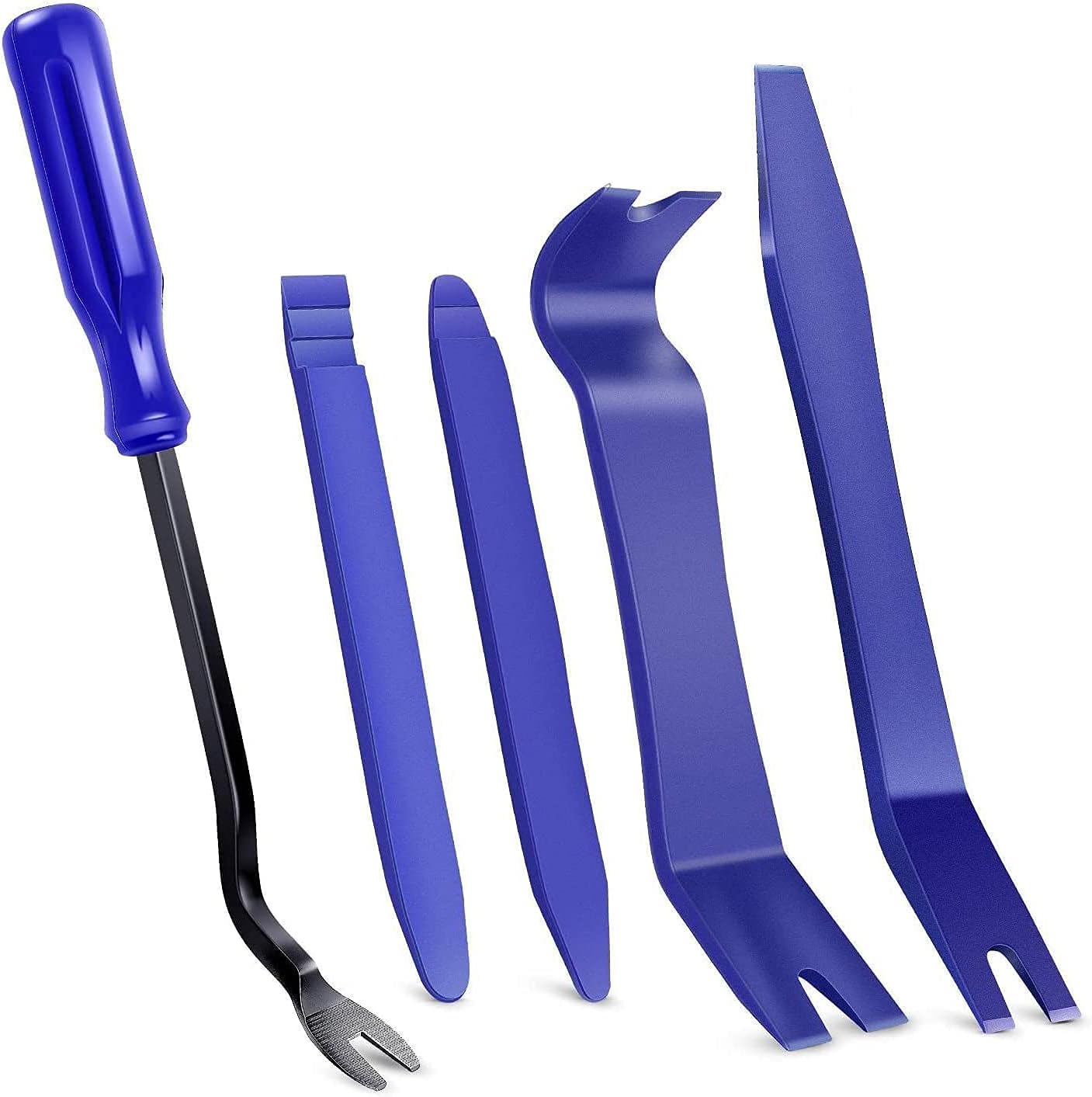

Clips are probably one of these varieties:
clips
Trim forks (can be found at Amazon/Ebay for a few pounds):
trim forks

Those trim tools are handy tools to have around for all sorts of things, especially the two pry bars on the right, for prising things open without causing damage. I had one of the cranked ones, but it fell out of a belt pouch at work and I’ve never got around to getting a replacement. I’ve got a steel one, but it’s much more likely to damage something.

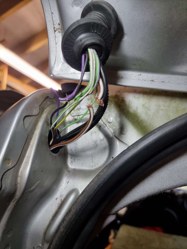

Bit of an update and thanks again now I am sorted.
got inside and tested the switch and the lock. Switch was showing a reading on a meter so assumed that was ok and ordered a new lock for £19. Replaced the lock and it didn’t work. Replaced the switch today only £13 but again no joy.
went searching further and found the below in the flex joint between the car and boot hatch. A bit of soldering and taping up and it is all working again. I forgot my wife said she didn’t think her heated screen was working a couple of months ago. Whoops.
