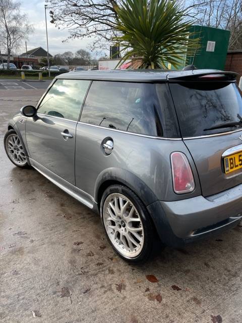

I have an R56 Cooper S, I really enjoy it but it’s not been without it's issues, I got a unabused one with 60k full history and I’ve done loads of work to it, luckily most stuff I’ve done myself, there are a lot of dogs about and a flogged unloved mini will be a money pit, not sure I’d recommend one.
@import you can get recon hpfp now, I fitted one to mine.
[url= https://i.postimg.cc/XYBKPLxc/5-F64-E034-C34-F-485-E-86-EF-7455-E4-DA696-A.jp g" target="_blank">https://i.postimg.cc/XYBKPLxc/5-F64-E034-C34-F-485-E-86-EF-7455-E4-DA696-A.jp g"/> [/img][/url]
