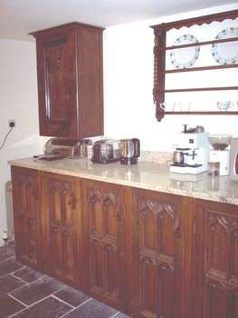

There are other timbers other than oak,ash etc. Try maybe looking towards something like tulipwood, as that quite inexpensive in comparison. But ever there thats quite mainstream. Research is your friend.
I did a kitchen out of reclaimed oak church benches for a customer, who had picked up a churches worth at auction and after having them live in a garage for several years gave them to us.
What a bloody nightmare. Hard to hide the hundreds of joints and mortices broken down furniture has to turn them into cabinets and doors, and the doors themselves needed to be in the lower units 80mm thick. What a long drawn out,annoying, brain boggling job that one turned into.
Limited pics of it. I suppose after that I didnt wanted to be reminded of the turmoil 😆
kitchen-gothic doors & cupboard
