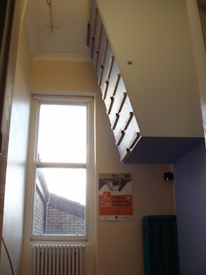

Posts: 1911
Chickenman, when he was a bachelor and had hair, had a 10 by 10 ft wall in his bedroom that parked against the wall but slid out on rails up the wall and out across the ceiling (up to 40 deg overhanging). The futon bed provided a handy crashmat.
I have no idea why I remained a bachelor for so long! 😯
