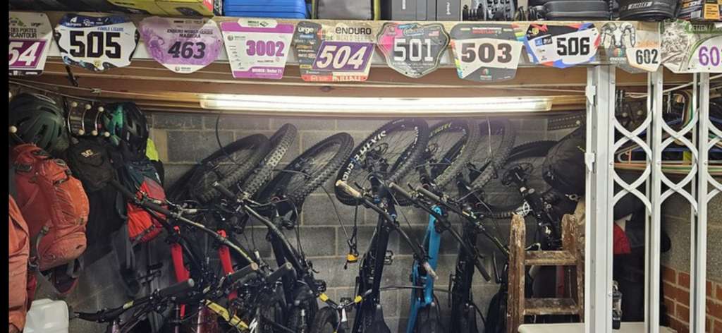

Posts: 9783
Mine are just fixed with large plugs and screws. Not had one pull out in the 20 years they have been mounted.
Had to move them further up the wall as bikes have got longer.
As above they are fixed so that the wheels are at 45% so that we can get the bikes closer together
Screenshot_20241212_141855_Gallery
Screenshot_20241212_141921_Gallery
Posted : 12/12/2024 2:20 pm
