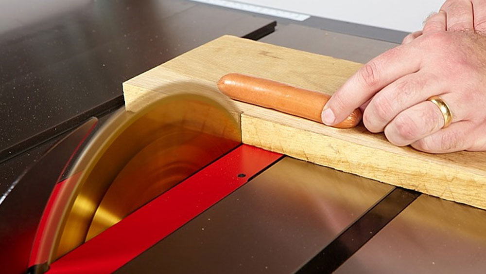

Here's what happens when you 'hammer' a sausage into a SawStop table saw blade.
Pretty cool tech this. It's been around a fair while now and I think is normally retrofitted to existing machines but it seems the company make the whole saw now which I wasn't aware of.
Mega bit of super slow mo near the end showing a sawblade tooth breaking free from the blade due to the forces involved.
Amazing idea, but I can't help but think most of these injuries are because in North America at least, they tend to remove the blade guard due to the prevalent use of Dado stacks and saw-sleds.
Still, pretty cool device and amazing footage. 👌

I'd love a sawstop saw though because it is a safety feature, but I always wondered how accurate the test is.
As with most here ive used big industrial stuff and in truth you or you hand isnt going to approach the blade a mm at a time very very slowly. the accident will happen a lot faster than that and its the result of a slip or such, but you'd be putting you limb into the blade quite fast
You want to test that thing properly. You switch it on, stand in line with the blade then punch it, because I reckon thats about the speed your hand would be moving at the time of an accident.
All the same a good thing for the lone worker.
Posted : 09/07/2020 1:15 pm
As with most here ive used big industrial stuff and in truth you or you hand isnt going to approach the blade a mm at a time very very slowly. the accident will happen a lot faster than that and its the result of a slip or such, but you’d be putting you limb into the blade quite fast
I think it would basically operate about as fast as an airbag in a car. Your body has to touch the saw to trigger it (it detects conductivity) so you will get a slight nick, but that beats losing body parts.
Posted : 09/07/2020 1:21 pm
@dyna-ti the Katz-moses video in the op also demonstrates pushing the sausage at the blade as fast as you can, works pretty well, though you would get a slightly deeper cut.
Posted : 09/07/2020 1:39 pm
I've watched a live demonstration of Festool's version.
Holey cow its alarming!.
Even though you've seen the videos and you know exactly whats going to happen you shit yourself anyway. I think if you unwittingly triggered the blade to retract in normal use you'd have a heart attack... but your corpse would be buried with all 10 fingers. (not Kayak's corpse obvs.)
The energy involved is spectacular. Its amazing that the mechanism works the way it does but its also amazing that in Festool's version, with a relatively light, portable compact saw, that the whole thing doesn't get wrecked. The mechanism itself destroys itself from the shock of the action of stopping the blade but somehow they stop that energy from twisting / breaking the arbor out of  the surrounding structure and the cartridge and blade can be replaced and the saw up and running again in jig time.
