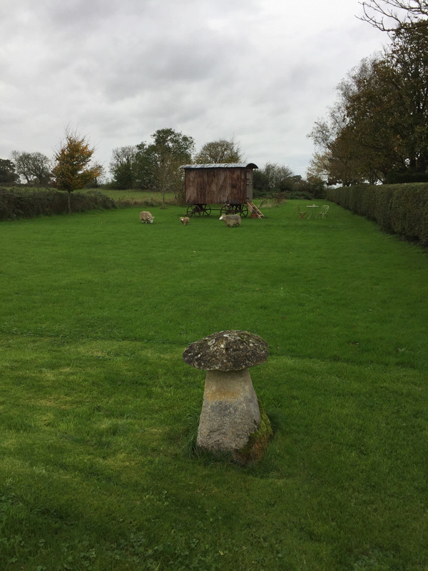

This one belongs to a friend of mine, who has visitors to her hotel stay in it! It’s a restored original 19th century hut.

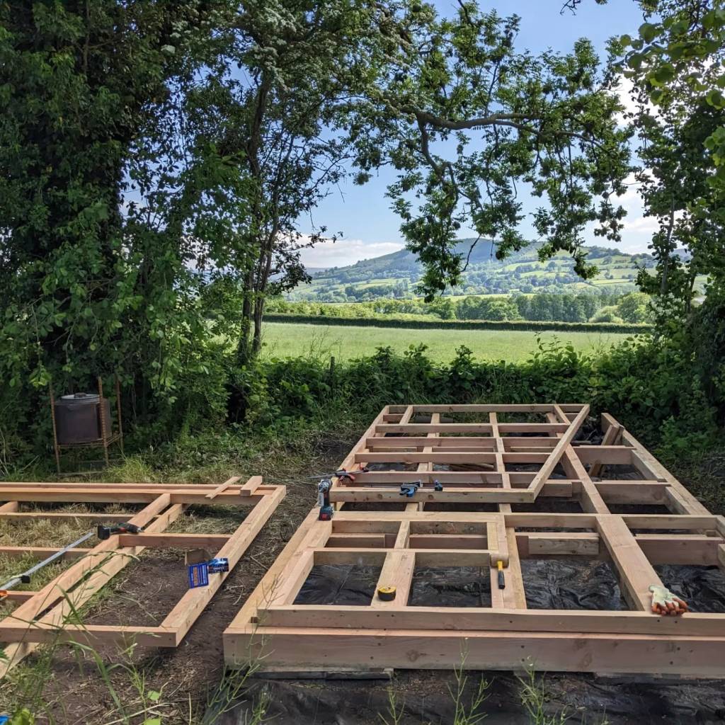

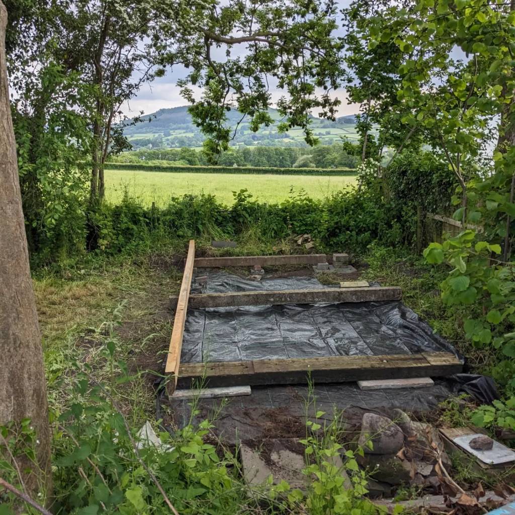

Shed going up at the end of the garden currently, dug out some soil, packed in some scalpings/type 1, weed membrane down, reclaimed paving slabs. Borrowed a long spirit level to get everything pretty close and then added some old slates as packers for fine tuning. Built timber frame on top of what you see.
shed start
Posted : 08/08/2023 11:31 pm
Posts: 3064
Should add that I only dug out under where the slabs were going, not the whole area under the weed barrier.
And with a bit more frame coming together;
shed frames
Posted : 08/08/2023 11:34 pm

Concrete lintels are the supports furthest from the camera in my shots, no idea of cost comparison as they were cleared from a friend's place and the sleeper is one of the last good ones of a shed that was in the same spot with a whole wall that was built of sleepers on their ends.
