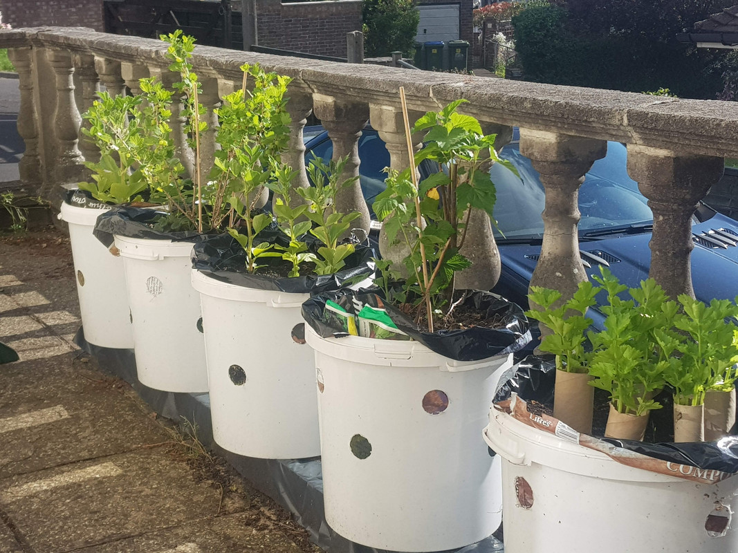

Saw this on the internets and thought it looked like a neat way of doing things:

So, thinking more about this, if you had a basin that drained into the toilet cistern, is there some sort of valve you could have so the cistern didn’t fill while the (cold) tap was running?
