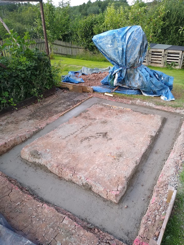

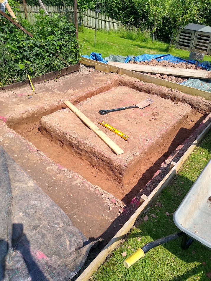

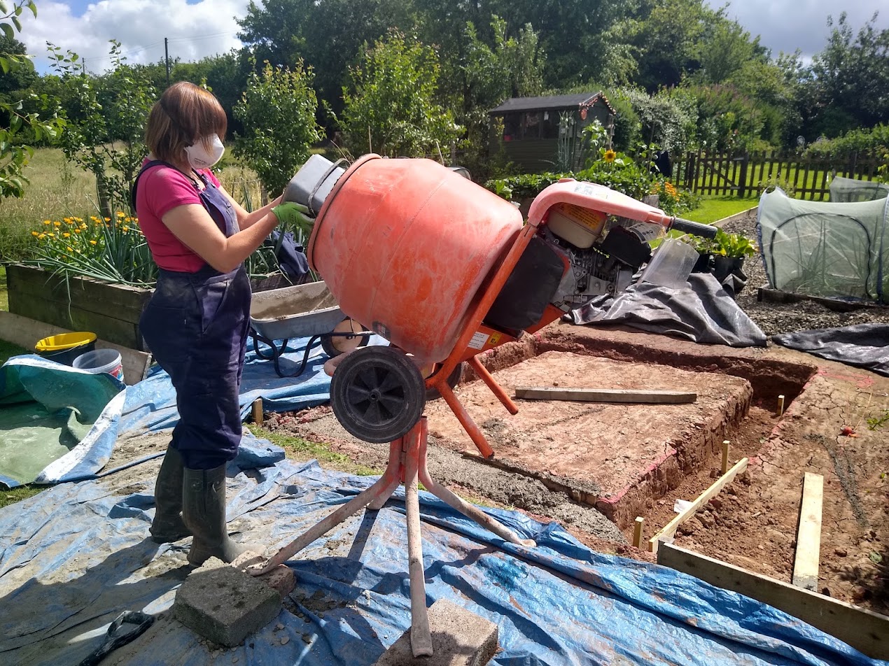

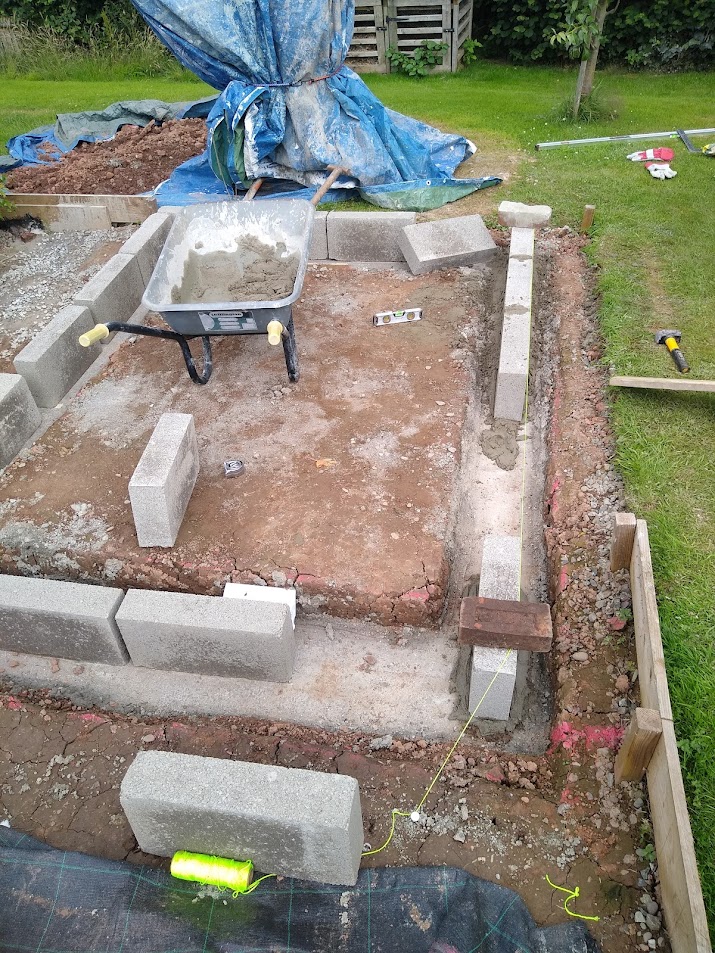

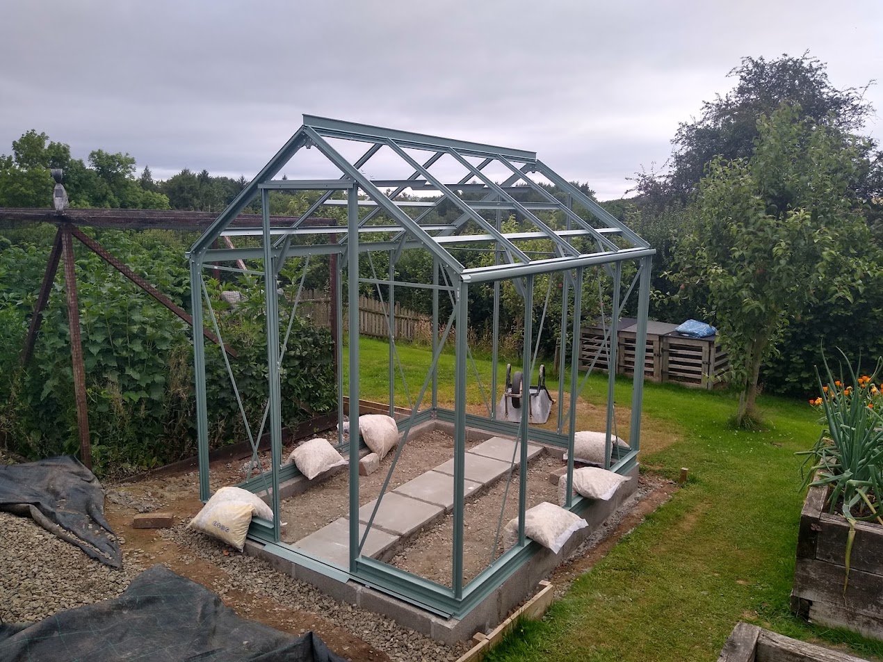

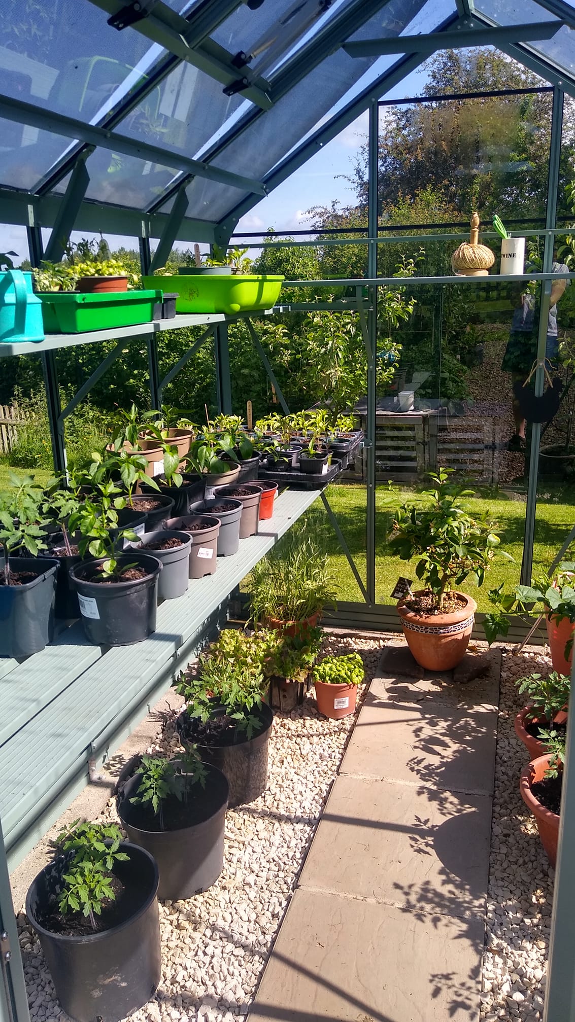

Our ground slopes in both directions.  I dug and concreted some footings for a single course block wall and bolted the frame to the top of it.  Because of the slope, at the the front, the top of the block wall is just above ground level.  At the rear, the whole course are is above ground.  I levelled the earth in the middle, laid a bed for a paving stone path up the middle.  Either side of the path was covered with a weed barrier then ornamental gravel.  Done during the first lock down.  I might have over engineered the foundations, but I had fun and learned some stuff! I even roped the Mrs in as a builders labourer. It looks great, a pleasing project.

@blokeuptheroad that is an excellent job, may shamelessly copy that approach.

I was about to pitch in with a long explanation of how I did the bases for two sheds. It’s pretty much how @blokeuptheroad did it.
Except he’s done a far better job. I didn’t pour proper footings. I dug trenches, then a 4” layer of scalpings, stamped down, then the concrete blocks on a concrete mix using just sharp sand. Normal laying mix between the blocks, then when set a mix of whatever was left either side of the blocks to encase them a bit, but still under the soil level.

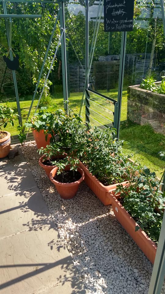

I'm not the gardener either, just groundsman/dogsbody so the following guess at an answer could be nonsense. I suppose you could plant in the ground, but unless your are growing lots of the same thing it's more convenient to have stuff in pots. We are (well, the Mrs is ) experimenting with lots of different varieties of chillies, peppers, tomatoes etc. these work well in pots so you can move them round or change over what you're growing if stuff doesn't do well. It's also really handy to have the smaller pots on the staging (shelves) so you have to do less bending over for watering etc.  In ours, the base is free draining under the gravel and weed mat so there is no issue watering everything with a hose.

Not sure either.  The instructions for ours (Rhino brand) said to erect it straight on level earth, slabs or on a dwarf wall as we've done.  I've got a few treated timber structures in the garden and they all rot at ground level after a few years.  Like you I wanted a construction method which will last and require minimum maintenance.
